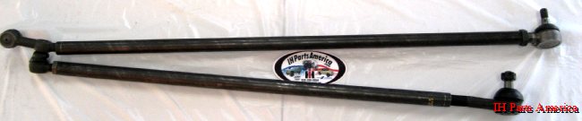

Hi - I am interested in the y link Hysteer kit. Mainly because it like like there is a bend that helps give clearance, which is what I want.
I have a 92 YJ a wrangler with a Dana 30. Anyone know if this kit would be compatible?
It may work. The kit is meant for a spring-over application, where the leaf-spring and steering arm aren't in line with each-other. You will probably also have to ream your knuckles out, as these use a 3/4 ton tapered end. If your Dana 30 has flat top knuckles, then you could use the 3-bolt forged steering arms that are already reamed.
Please advise that you will need to do further research on your behave to see if it will work for your specific application. Let us know if you need any other additional information on the kit.
