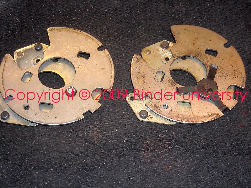

Here is an inexcusable "po workaround" kinda deal on a four cylinder variation of a 1510. This is a 196 application in a s800 that was sent in for rebuild.
Someone obviously dismantled the distributor and then purposely jury-rigged it. No way a stable timing or dwell factor May be achieved with this unit.
The upper breaker plate on these units mounts the points and condenser (and ground lead), it's connected to the actuator arm on the vacuum advance so that it is free to rotate slightly to vary the vacuum advance timing. It slides on three plastic "bearing" points that can be replaced if worn or missing. The movable plate is retained to the stationary plate by a three-lobed spring clip underneath, and pivots from a pin/bushing setup.
If the distributor is a later variation "gold box" electronic trigger unit, the points and condenser set is eliminated and replaced with a hall effect trigger and a reluctor in place of the breaker cam, otherwise the plate assemblies are identical.
Pic shows on the left, the botched plate...the pivot has been replaced with a pop rivet that is not completely "set" so the plate will move. Plate on the right is an original one correctly assembled but dirty. Also the scruud up plate is missing a bearing point.
What this means is the breaker plate just flops around and has no "drag" imparted to it by the retainer spring to inhibit movement except in the rotational plane. That means, when the engine is running, the dwell will be impossible to set for a consistent value, and the timing will vary tremendously, no way to make the engine behave nicely with a pos distributor like this one!
And if ya swap a pertronix into a unit like this, you have just tossed yore cash down the rathole.

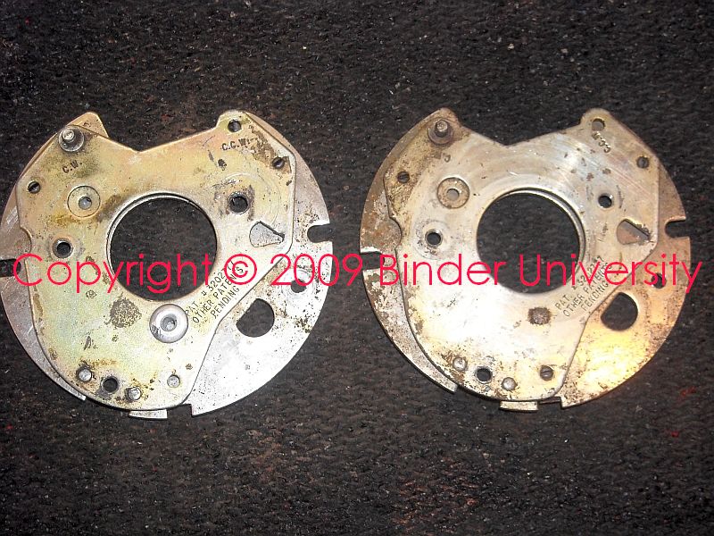

Here is the bottom of the breaker plate assembly shown above. On the left is the po virus unit, one on the right is oem.
Notice the retention spring/clip on the oem part.
Not only does that rivet allow the plate to just flop around at random, it prevents the plate from sitting perpendicular to the rotational plane, that means the dwell (point "gap") varies for every cylinder in a random manner...that in turn allows the timing to wander all over the place!
This is exactly why I always advise gutting out and inspecting any distributor that is being serviced/upgraded. To install some other trigger (pertronix), or even attempt to replace the breaker points in a unit like this is a total waste of effort.
