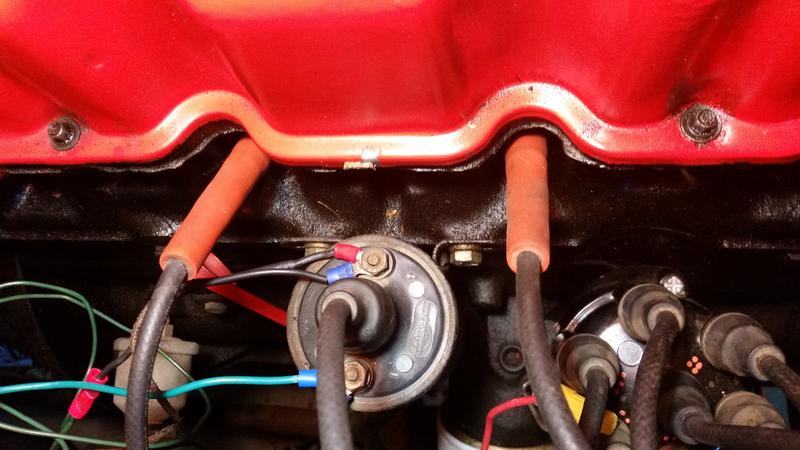

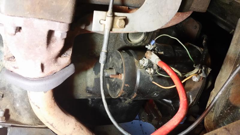

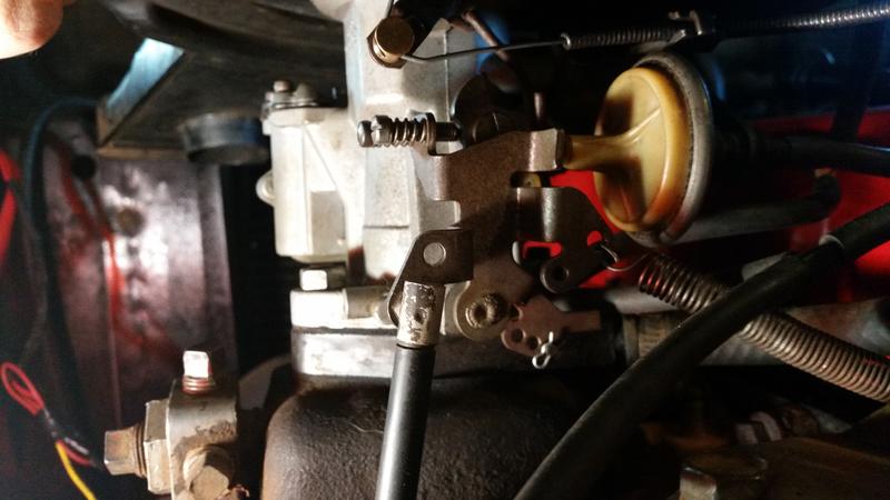

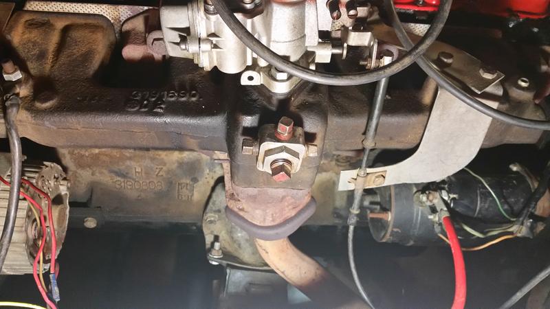

Can you post up a picture of the back of the carb, your coil and of your starter?
Chappie, is there a different carb gasket that is supposed to be used that has a lip on it to block some heat from the manifold? The picture should clear up if it has the right gasket under it.
It sounds like sometimes it turns over and won't spark and sometimes it won't even turn over. If it won't turn over then I would look for the heat shield that is between the starter and the exhaust. If it will turn over but won't spark then that sounds to me more a problem with the coil.
Not familiar w/the 232, but on a 264 I had there was no heat shield for the starter. Most i6 engines I've seen don't have or need heat shields.
If funds are tight just buy a new solenoid. On an i6 it can probably be replaced without pulling the starter. They are a dirt common delco part. Just pull it and place it on the parts counter and say give me one of these.
Here they are. I just noticed the float bowl cover is leaking. I tightened it up and you can kinda see in the pic of the carb, the ears are starting to bend.
That green wire (changes to black at coil) should have a full 12v when cranking. Remove both wires from the coil and put a meter on that wire and see if you have voltage when cranking.
