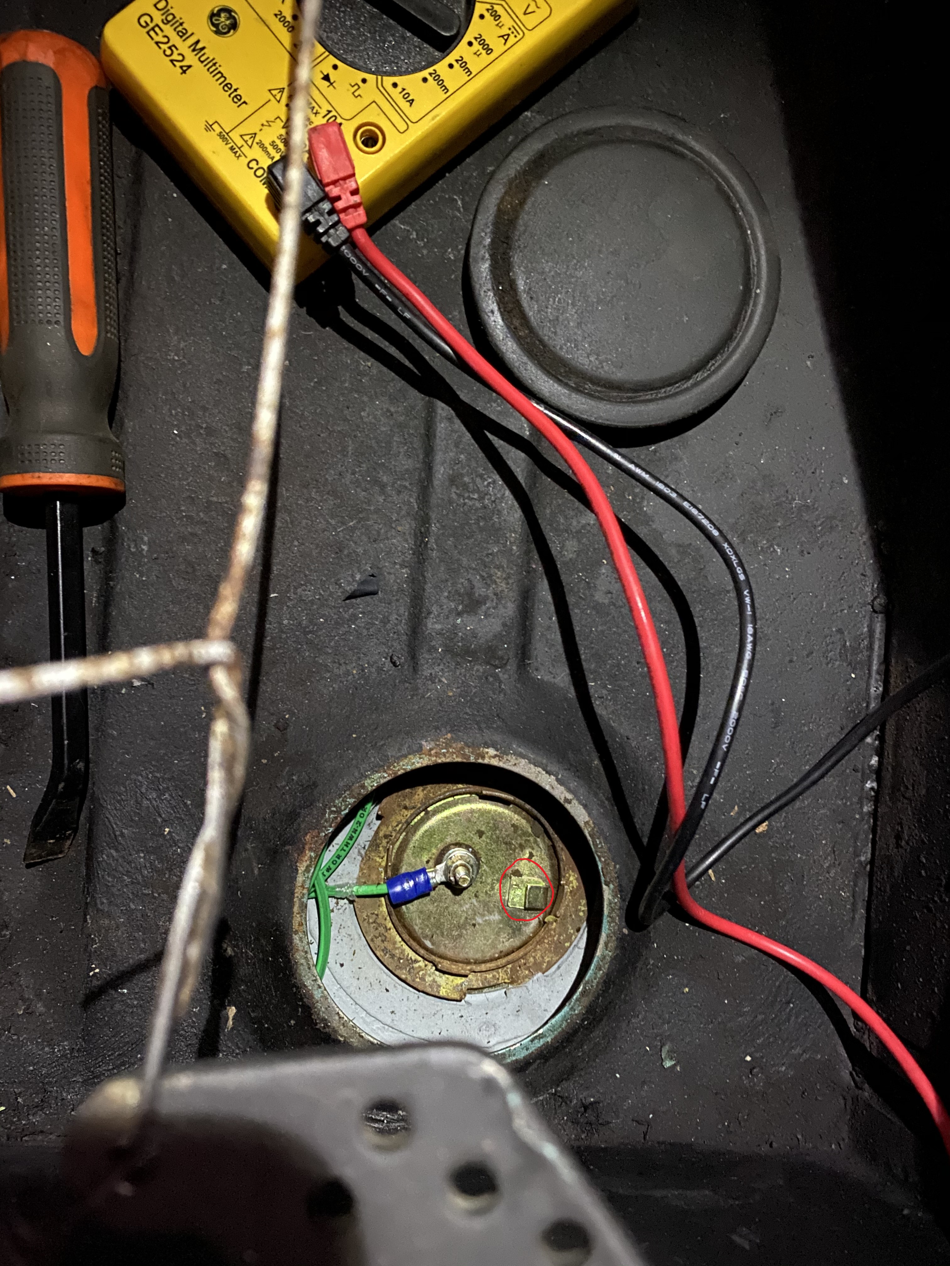

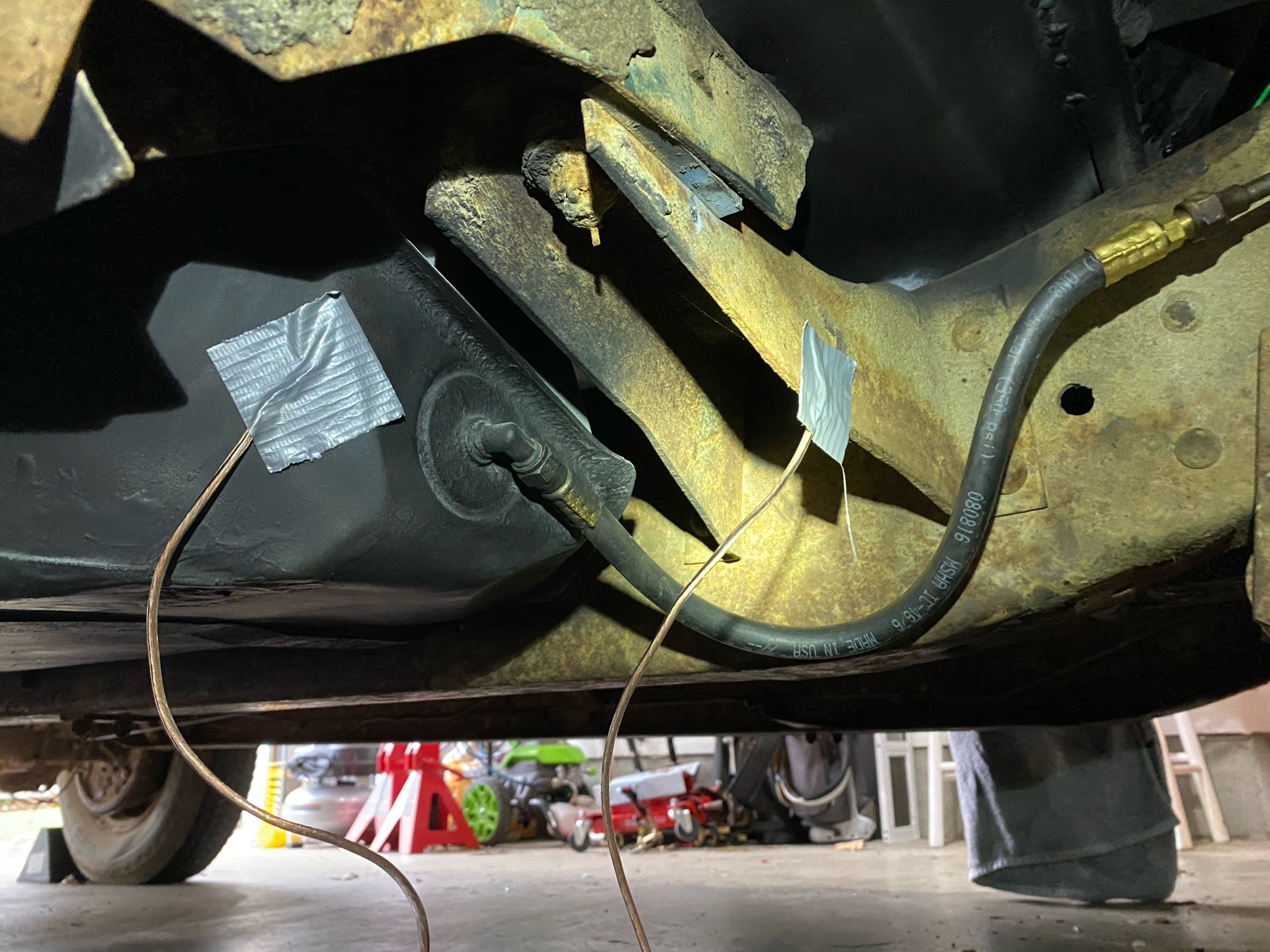

When I have it connected to the fuel sending unit, the needle reads empty and doesn't move. I've tried grounding the gas tank by sanding down to bare metal and connecting a wire from the frame to the tank, but that didn't help (photo attached). I also tried running a wire from this little bent piece on top of the fuel sending unit circled in red in the last photo.
After trying to ground the tank both times, I used an ohm reader on the line coming from the fuel sending unit to the gauge against a ground in the cab and it wasn't actually grounded. Also just using an ohm reader on the threaded post of the fuel sending unit to the top plate of the unit read 1 on the ohm reader. I would expect that to be between 0 and 1? I really don't know what I'm doing!

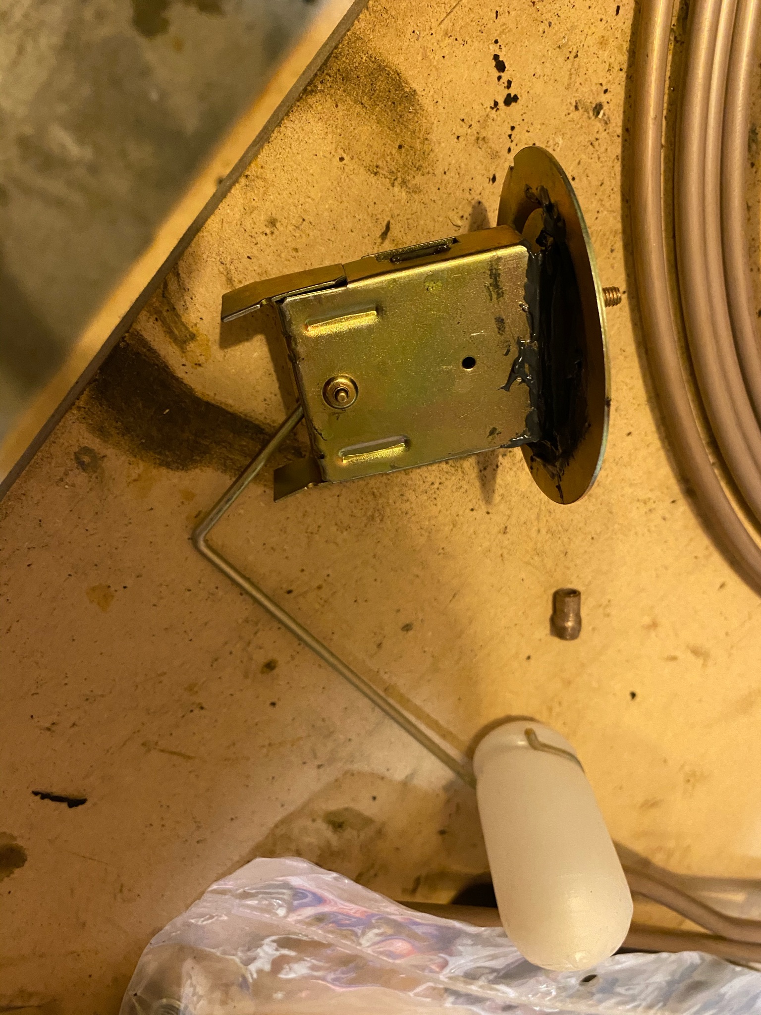

I may have solved my own problem. The fuel sending unit I bought didn’t fit properly and the guy I bought it from suggested I try to modify it.
I broke it off at the cover and JB Welded it in the center instead of off to the side. Of course this is breaking the circuit.
