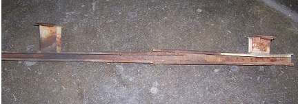

passenger side. The inner one that goes between the wind wing and up/down window that has the windwing sliding into.
I have been replacing the manual window cranked regulators to install power windows. And the one track on the passenger side is rusted to the point of no return. Even though it is somewhat usable, I would rather replace it.
The rest of the tracks are fine. Minimal surface rust.
I am also looking for the felt that goes into all four tracks. And recommendations would be appreciated

Bump
anybody have any leads?
Passenger side window track. The one that goes between windwing and cranked window.

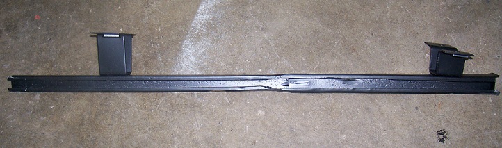

Well, it's always good to have friends in the right places. Soon after I made this post, a good friend of mine who works at a powder coating place, saw what I was working on and took the piece into his job to clean it up in his blasting machine. Well, he did more than that, and just droped it off this afternoon all fixed and powder coated :dita:
now I can start putting the passenger windows back together. Maybe I should have had ther window tracks powder coated. Maybe next time.
