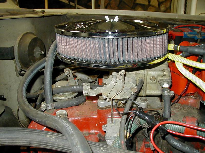

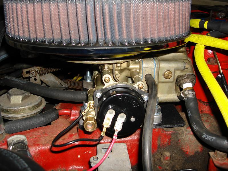

Hello patrick, between the 45-223 and the 45-224 I could not say because I did not see the 45-224 listed when I was looking but I did just recently purchase and install the '223 and I prefer it by far to the manual pull.
