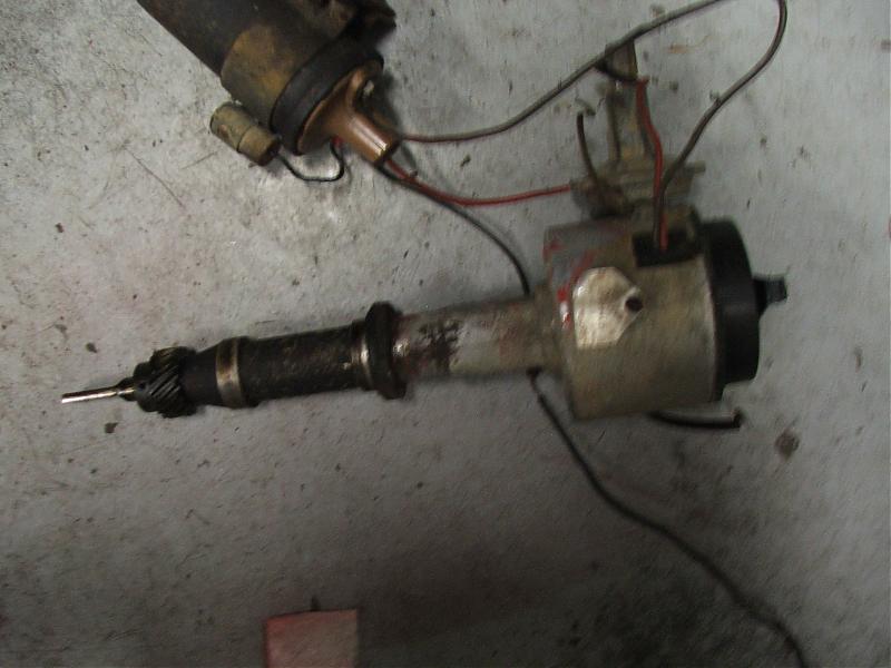

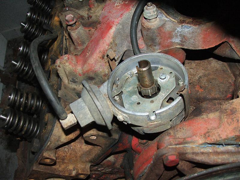

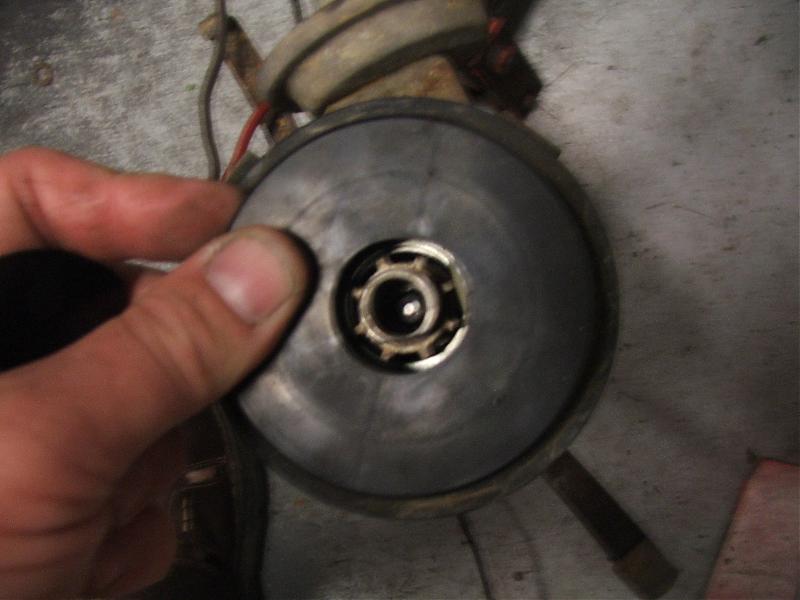

I have a distributor out of a 304 and the distributor that came out of the 345 that I have been rebuilding. I have pics of both distributors. Which distributor should I use? It will be used in a 345 Scout II 4x4

Your first pic is a prestolite electronic trigger.
The other pic is a Holley electronic trigger, aka "gold box".
Post the part numbers for each so that the version of the original advance curve May be compared.
