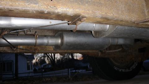

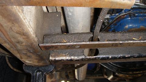

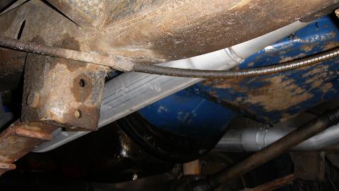

My local shop put on imco 'turbo' mufflers on mine with 2 1/4 all the way back and following the stock dual routing. They are quiet at idle and growl when you get on it. Going downhill when you let off the gas it has a nice burble burble burble.

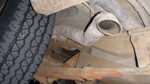

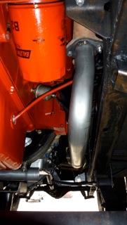

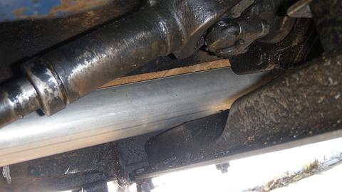

Any way you could snap a pic of stock pipe routing?
When I bought my s2 it didn't have any exhaust.
Cheers...
See if these will help.

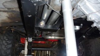

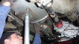

Here's some shots of a smog legal, catalytic equipped sii. Single exhaust out the back on the driver's side.

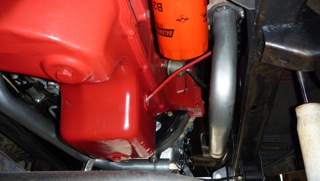

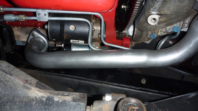

Thanks so much guys. Those pics are great.

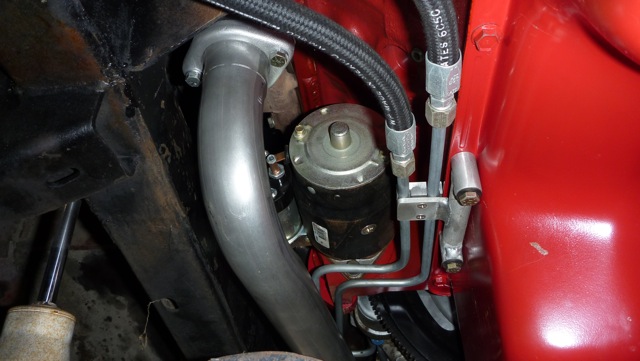

I hate to ask for more, but can I see the routing from the collector reducer on the passenger side. I want to make sure I'm routing around the starter properly.
Thanks again!!
Thanks dealbreaker.
That's exactly what I neened to see.
I like your fuel line setup by the way. Very clean.
Cheers,
Those are the trans cooling lines, actually. But thanks, and I hope you get your rig rolling too! Post up some pics as you go.
