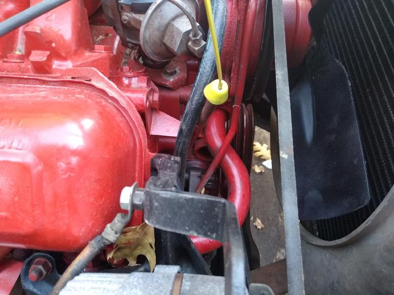

C Catchb52 New member Oct 19, 2019 #1 266 v8 has a hole just above the fuel pump that goes into the timing cover. It did not have a plug when I got it. What went/goes in this hole? Can I just put an expanding plug in it? Attachments IMG_20191018_173910814.jpg 69.2 KB · Views: 598
FDChappie Well-known member Oct 20, 2019 #2 That was for the old style oil fill. When the PCV valve was added, the oil fill moved to a sealed cap on the valve cover.
