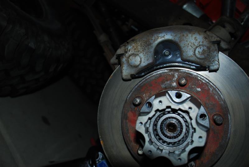

Well, after further messing with it, looks like I do need a new hub body. Just one side, the other side went on like a champ, no issues. The one that I originaly had to drill out the the holes seemed like that would work, after trying to get it on the vehicle though the holes are too far out towards the edge...seems like it might be made for a different axle or something? I wont be able to drill the holes to make it work any better than what ive got and the bolts just bind up, if I can get them to even start in the holes on the hub.:crazy:
Sounds like you got a incorrectly packaged set. As soon as my supplier opens up I'll give them a call and see what I can work out.
Here are some pics, hard to see, but the holes are just out of alignment, enought that I could get one to start. But then the rest wont go.

here are some pics, hard to see, but the holes are just out of alignment, enought that I could get one to start. But then the rest wont go.
I haven't forgotten about you steve. Still waiting for a response from warn.
Figured it was something like that, not in a real big hurry, planning on putting this on a trailer in June and dragging it 4000 miles to texas, so if its not put together by then no big deal. Thanks for the help with this.
