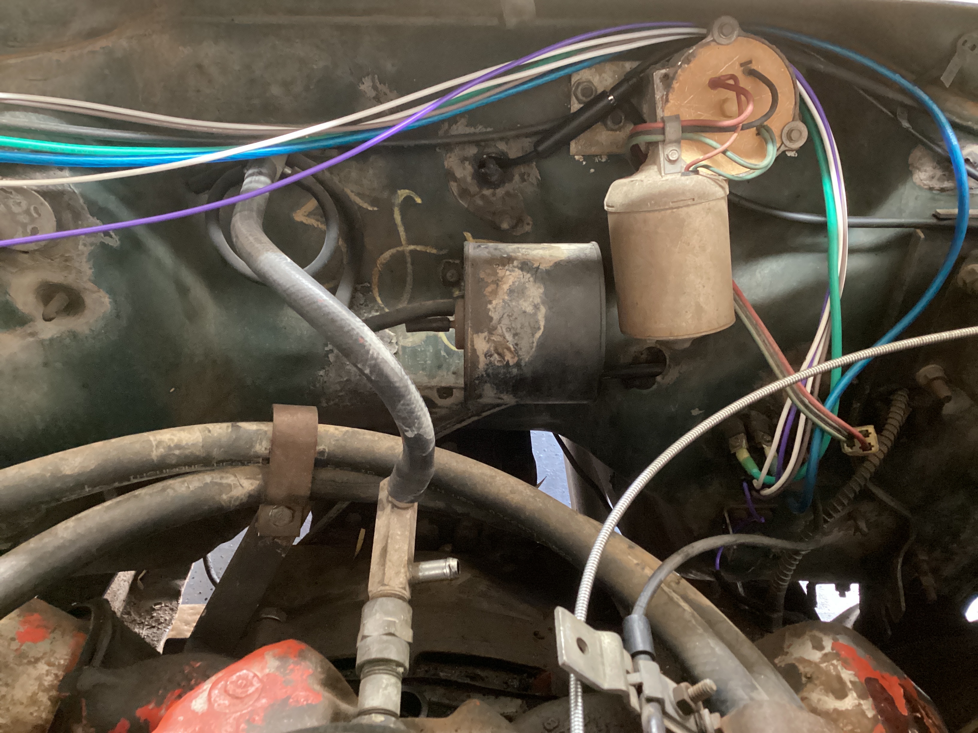

I have a 1973 Scout II that I am trying to do the vacuum lines on. I do see similarities with the one you posted, but the ports off of the carburetor are different. I only have 1 vacuum port off of the mounting plate at the front. It is a closed top carburetor. Would you happen to have a diagram that would match this configuration?
What engine do you have? That PDF file pertains to model year 1973 Scout II having SV8 engines (304 or 345) and factory original Holley 2210 2bbl carb. If any aftermarket equipment is in place on your engine, that would certainly change the equation. I don't know what you meant by "closed top" carb. Please post pics of your engine with air filter housing out of the way if you don't know what you're looking at.
