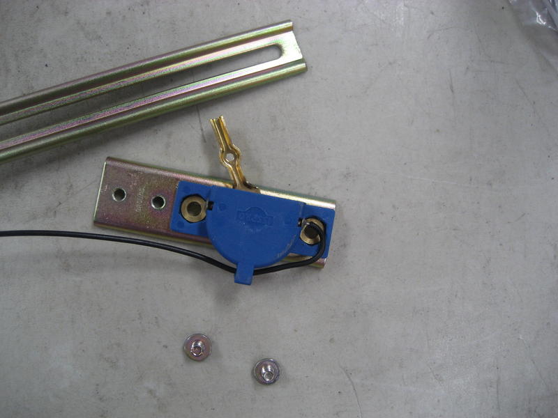

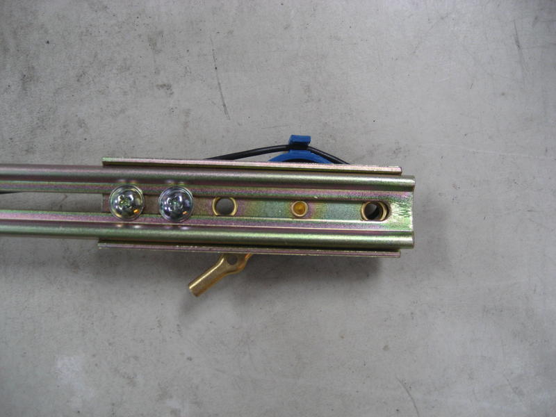

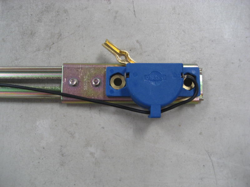

Could you post some detailed pictures of this part. I have a GM tank that has been modified and put on my d200. I would like to continue to use this tank, because it has a fuel return port on it, and I am running efi. The issue I have, is the sender in it is 0-90ohm. I am looking to purchase the universal sender that you sell, and grafting the two together. Mounting the float and resistor from the universal one you sell, to the GM one in my tank.
The entire sending unit comes apart. A brass bolt holds the adjustable track, ground wire, gaskets, and the top mounting plate together with a spanner nut on top. The swing arm/resistor portion moves up and down the track by tightening/loosening two screws while the float arm is a cut to fit deal. Since the resistor piece is its own unit, you can completely remove it from the rest of the sender quite easily. Do you need any pictures in particular of a certain area? Thanks.
Here are some pictures.
