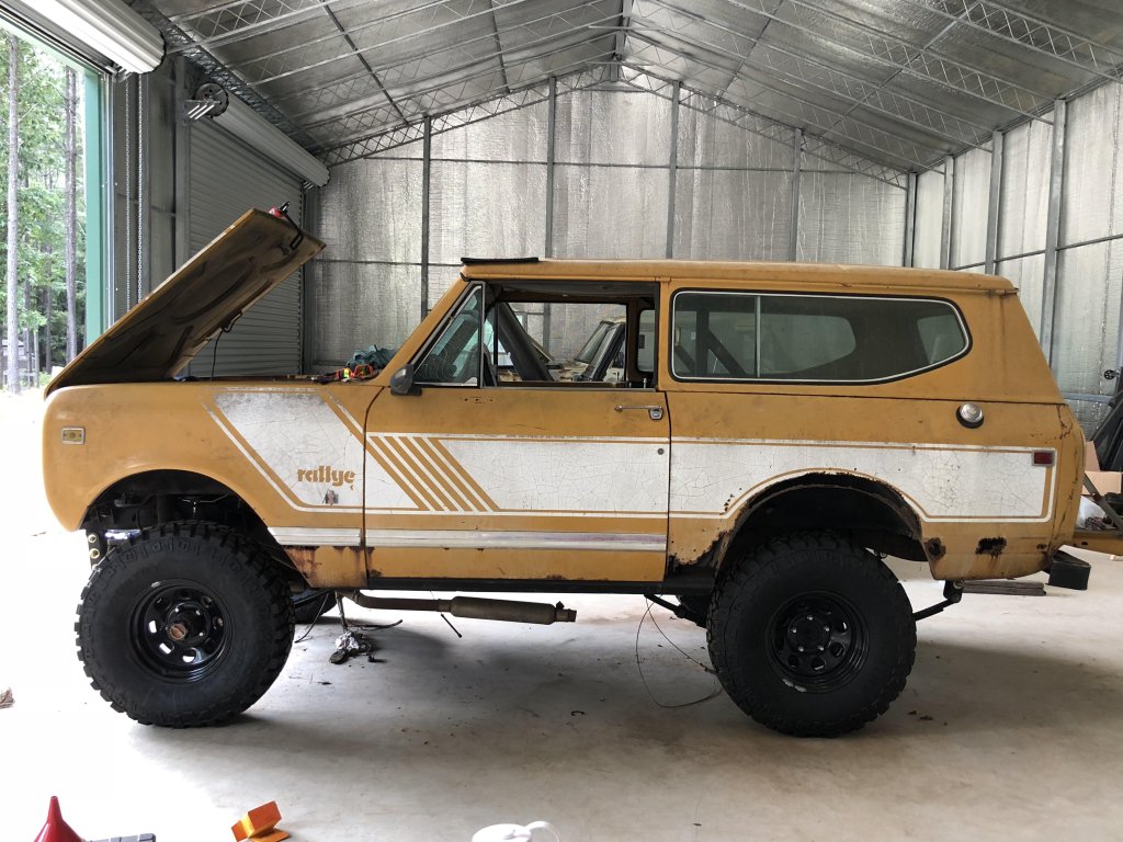

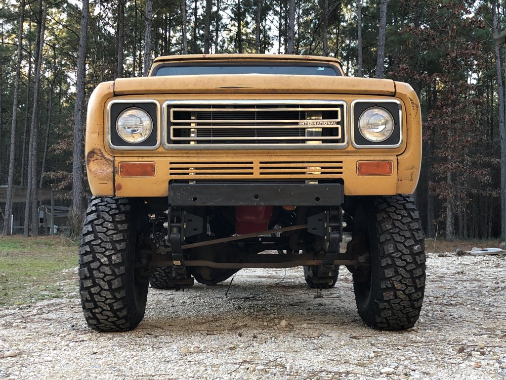

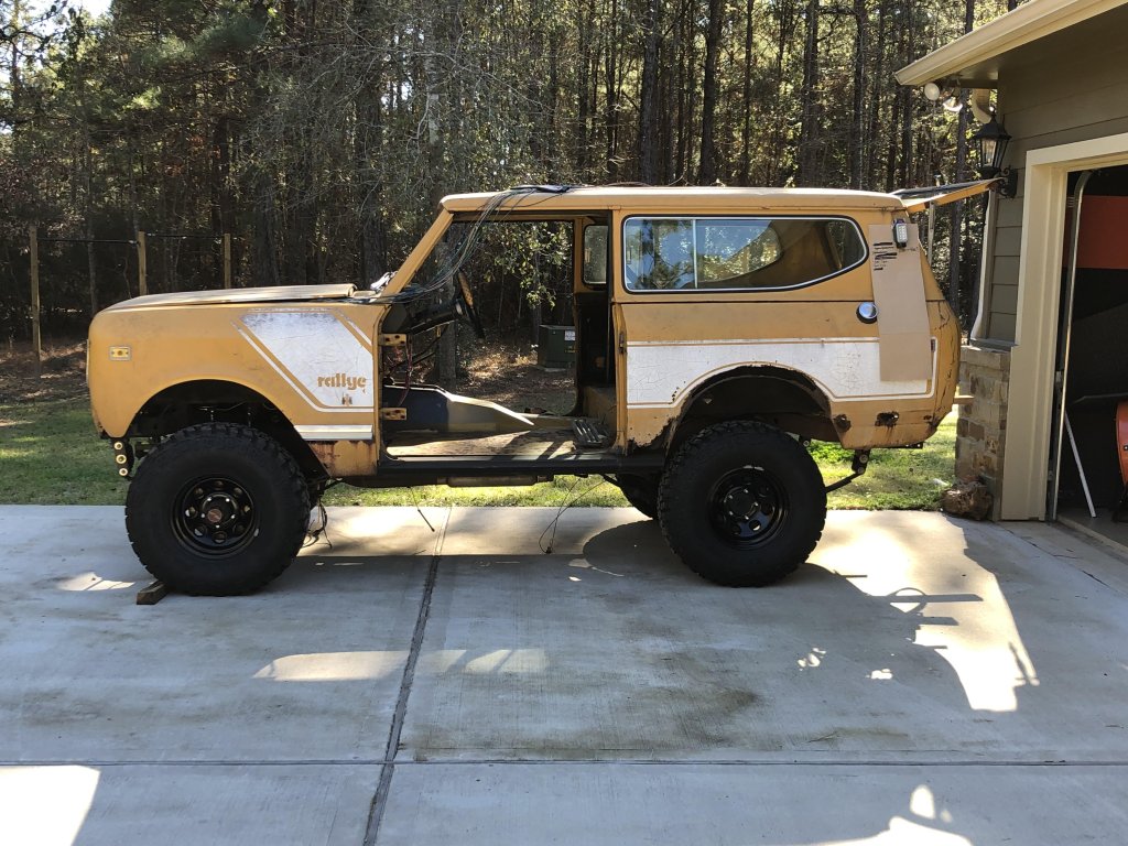

old pics of scout with 33s and4"RC lift springs.
