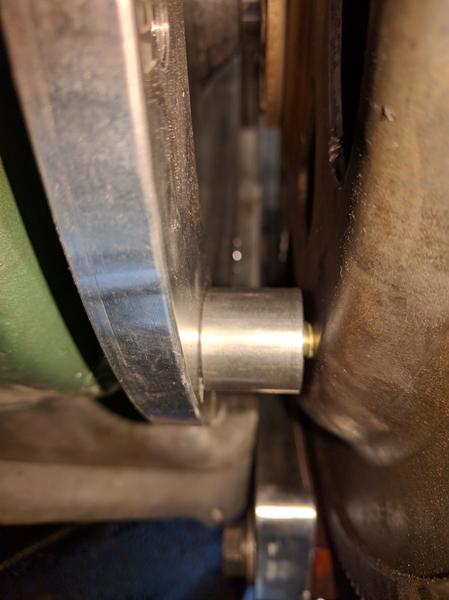

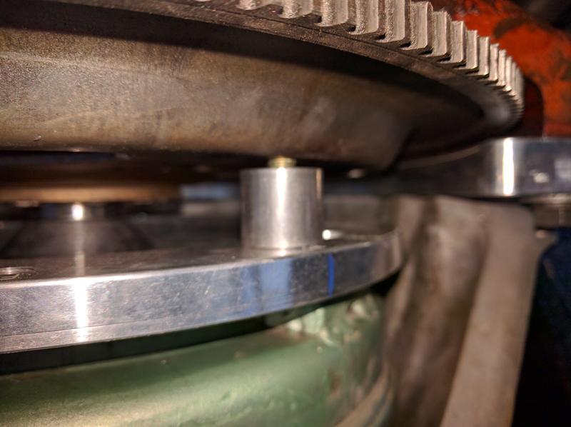

Attached are pictures of the spacers when installed. I measured the spacers and they are 0.902 inches long. Is that the correct size?

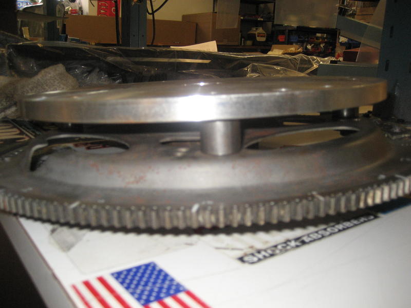

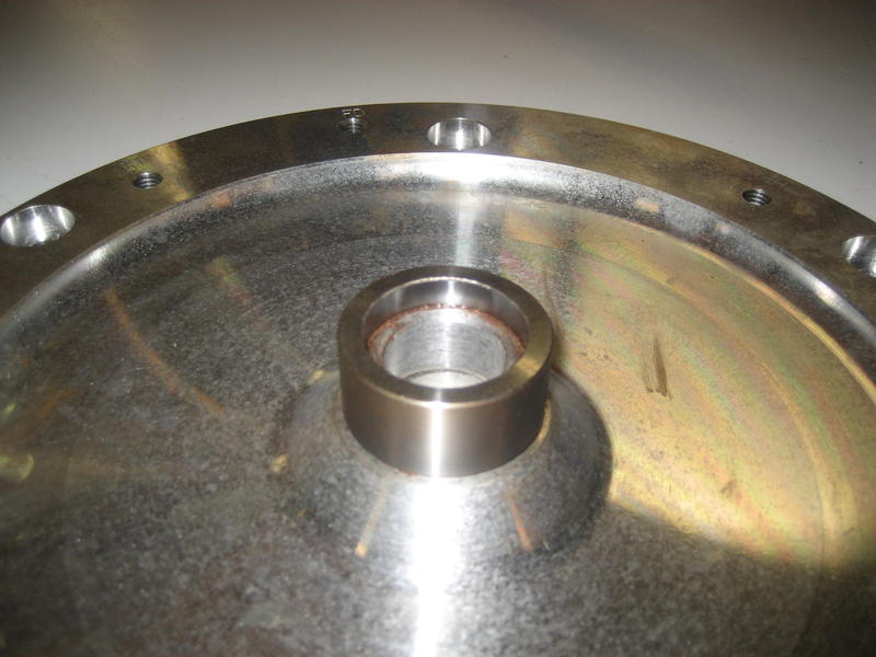

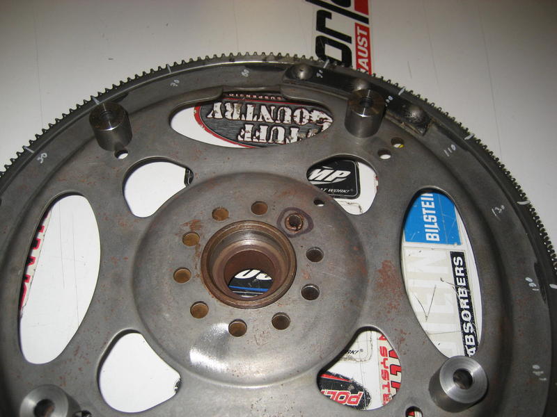

We had a kit on the shelf and put it together up in the shop this morning. The flex plate spacers did measure out at .902. The crank spacer needed to be sanded a bit to get all the rust out of it so the steel sleeve slipped in nicely. Darren then tapped that steel sleeve on the aluminum torque converter adapter with a dead blow. We then slipped it into the crank spacer and the spacers lined up perfect between the flex plate and adapter. I would check and see if the steel sleeve is seating all the way into the factory crank spacer as I could be getting hung up. Thanks.
