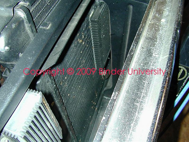

I also "seal" the space between the cooler and the air-on side of the radiator using dense neoprene tape ("camper tape" around the perimeter of the cooler, about 1" wide. That allows the fan to pull air through the entire cooler package which enhances it's performance, other wise much air is "spilled" around the cooler and reduces it's effectiveness. This phenomena can be easily seen in "smoke test" when these systems are run in a wind tunnel.
This pic shows a hayden prf cooler mounted on my personal tow rig, an older pic, this setup has been refined somewhat over the years as the radiator is now mounted in an isolator setup to prevent on-going failure due to frame/front clip/radiator core support flex.

It seems like running those zip ties through the fins would be bad in the long term. Would it be better to fabricate some brackets to mount the cooler on?
it seems like running those zip ties through the fins would be bad in the long term. Would it be better to fabricate some brackets to mount the cooler on?
Those are not "zipties"!!
Those are a dedicated fastening system. Some designs make 'em removable for future service, some do not.
I've been using that nylon mount system for over 40 years with all three common design heat exchangers, never had a failure, never had a problem. If the mount system was not up to par then no manufacturer of these aftermarket parts would accept the potential liability of using that system.
Maximum efficiency of the prf-design heat exchanger comes from sealing it as described to the radiator air-on face.
The oem trans coolers used by ihc and all other oem back in the day were tube and fin units or a very early form of parallel flow. And they leak constantly (mechanical failure) when mounted to brackets in a "stand-off" mode due to radiator core support flex and vehicle vibration. Also since they were not sealed to the radiator, their efficiency is very poor, most have at least one inch of dead air between the two heat exchangers. Back then, items like that were a total afterthought. But the heat exchanger technology (for all types of applications) in the last 15 years has changed tremendously and today are an actual engineered unit but have to be somewhat universal in their mounting arrangements.
My B&M super cooler came with those mounts, and it just looked cheezy to me. But your logic about airflow does make sense given the density of fins in the cooler. I will have to take a look at my super duty but I could swear it has its transmission cooler on a bracket that sits at least a inch off the radiator, it appears to be the same design as the B&M
