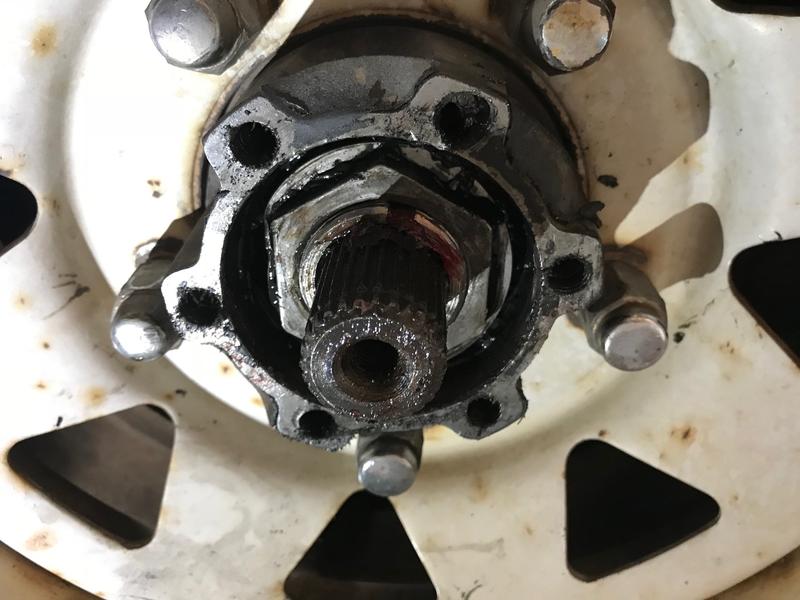

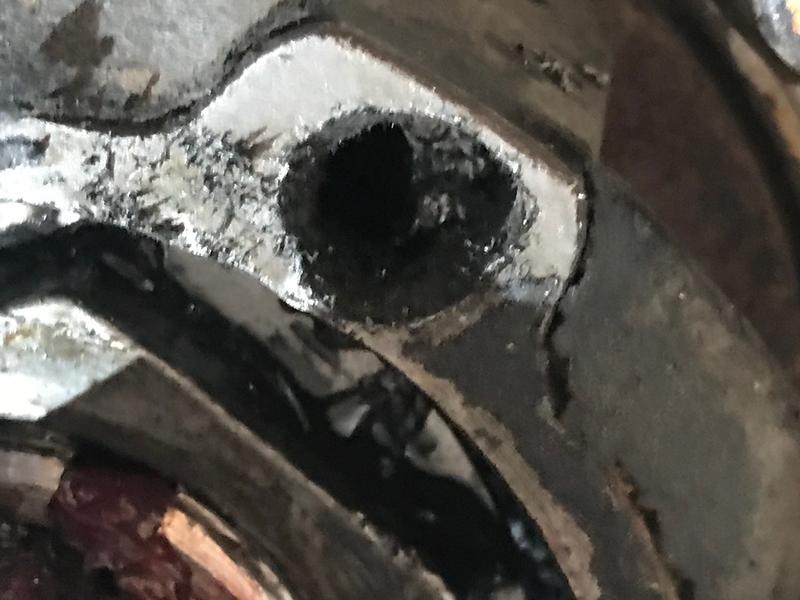

i do alot of 4 wheeling and last trip out, the hub bolts must have been loose and 4 out of 6 broke and as they broke the holes got egged out. so hub needs replaced.

so it all went pretty simple, just time consuming. especially installing wheel studs. i dont think these can be beat in to place, or im just not strong enough with a hammer. so i used a blot and shims and wrench and pulled them in to place.
so a question, i bet the lock washer over the first nut. near the bearing now im starting to think i should have bent the tab over the second out side nut. does it matter what nut has the tab bent over it ? ?
out side nut has 130 foot pounds on it.
inner nut was had 30 foot punts on it, then backed off 1/4 a turn

The lockwasher is supposed to be bent to retain the outside nut from backing off.
ya on Sunday i took it back apart and put the washer on the correct way. i dont know why in my head i screwed that up.
