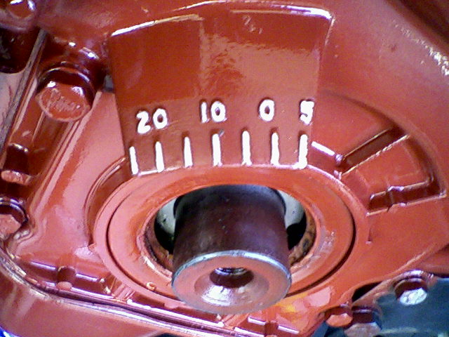

The timing marks for setting timing with a timing light are on the timing gear cover, picture attached.
"0" represents 0 degrees or tdc. The numbers to the left of "0" are btdc or before top dead center and are in 5 degree increments or 25 btdc, 20 btdc, 15 btdc, 10 btdc, 5 btdc, 0 tdc and 5 atdc.
This will get you up and running, then as you know, do the power timing to get the most out of your engine.
