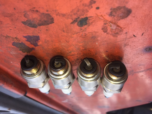

so, I have pulled the plugs this weekend (600 miles now). please see attached. I appears to me that the carb is running a bit rich? given the carbon build-up. would appreciate feedback. does anyone notice any other issues that I am not seeing? it is a new engine and just breaking, so one question I have is: would the plug condition clear itself out after more miles, and that this carbon is due to engine break-in? thanks for the input.

Looks like the mixture is ok to me, based on the clean plugs. Perhaps the rings on some cylinders haven't seated yet.
I agree with FDChappie. Plugs look good. Maybe you need to stand on the go pedal hard for a few miles and spin 'er up real good. Rings will love you for that!
