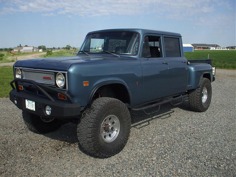

Hey guys Jeff has been good to me and I thought you all might enjoy my junk. A 1970 travelette, stats are 7.3 IH deisel from a 27 foot box truck 1978 vintage. Also has big spicer 5spd and one ton axles. I installed 6" Chevy lift springs, shackle flip in the rear and 4" rear blocks to level it out. I also did lower links in the rear to control spring rap as this rig is my tow rig. I had a friend paint it with ppg paint after about 80hrs body work.

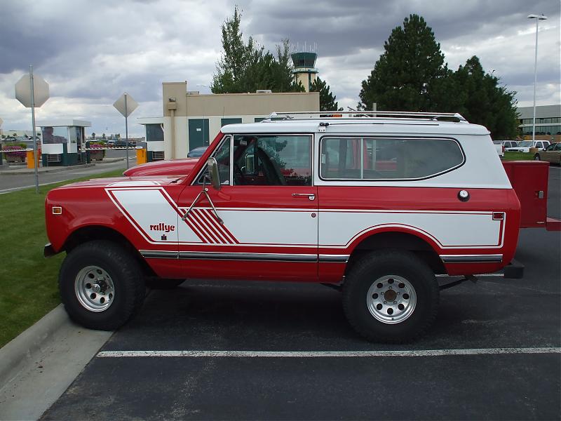

Next up a 1979 rallye was very nice, all orgional red rallye,345, 4 barrel, 4spd, air cond, power steering, power brakes, ect. I sold it just the other day for 10,000 can't drive all my junk and the cash wasn't bad eather....

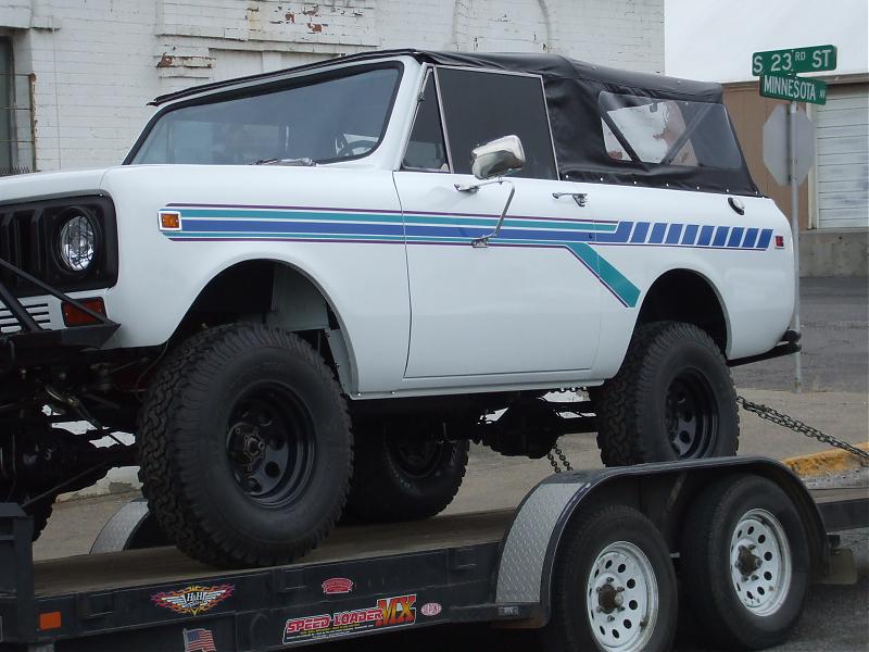

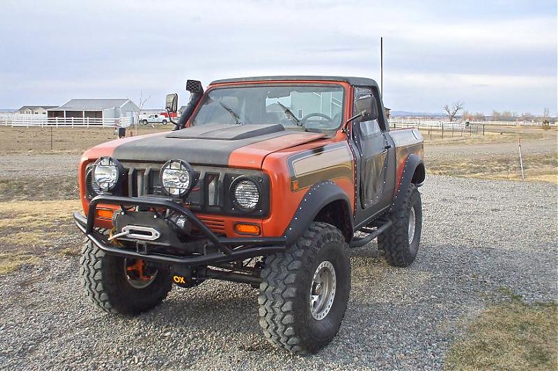

Next is the wheeler, it has 4 links frt and rear, coil springs, 37" tires on bead locks, it has a hot 392 that a little tired so I am have jim malus build me a new fire breather for it. I am also doing a trans change this winter doing a IH direct 5spd, and a 203/205. The Scout has a 60 rear 4:88 ox locker and a 44 frt 4:88 ox locker w/alloy usa axles, dunbar knuckles, and top steer set up...........

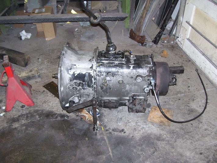

Travelette got the spicer 5spd from the box truck and had to have a spud shaft made to hook up the tcase
It is a direct drive, and I am thinking the first gear is way low like around 633:1. I have a gearvendors od I May install haven't pulled the triger yet.
