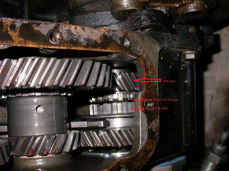

Have a Wide T19 with a Dana 300 behind it in a 75 Scout II. Am getting a loud ringing/growling noise coming from the transmission cover on the freeway over 50 mph. This only happens when I lift off, or step on the gas, and stops fairly quickly. Cruising steady state there is no noise. Thought it was a problem with transfer case shift arms or bull gear, so pulled the cover on the D300 to look. Everything in there looked good, but I can move the bull gear and transmissions main shaft in and out about .012 to .015 (used feeler gauges). I can see the nut holding the bull gear on moving in and out with the gear, so its not a matter of the bull gear being loose on the transmission output shaft. Measured between the end of the D300 output shaft and the end of the bull gear. Can't find a spec for this end play anywhere, but the Close T19 on the garage floor doesn't appear to have any. Does anybody know how much if any end play there should be before I pull the Wide T19 out ? I kind of equate swapping these trannys with having a root canal.

Pulled the 4 degree axle shims out of the back, and it didn't make a whole lot of difference. Crawled underneath and tried to find something loose. Frigging big nut holding the yoke on the transfer cases AA heavy duty output shaft was backing off, letting the rear output shaft wiggle a bit. Pulled the nut off, re-applied some silicone to the back of the nut, added some locktight to the threads, and re-torqued the aircraft nut to 150 ftlb. The axle shims are staying out for now. From what I read, if the driveshaft only has two u-joints, the yokes of the transfer case, and the rear differential are supposed to remain parallel within a couple of degrees. Being offset is OK as long as it is not too much. Not sure if something "wore in" or the nut just backed off, but will definitely be checking it anytime I'm under the Scout from now on.
