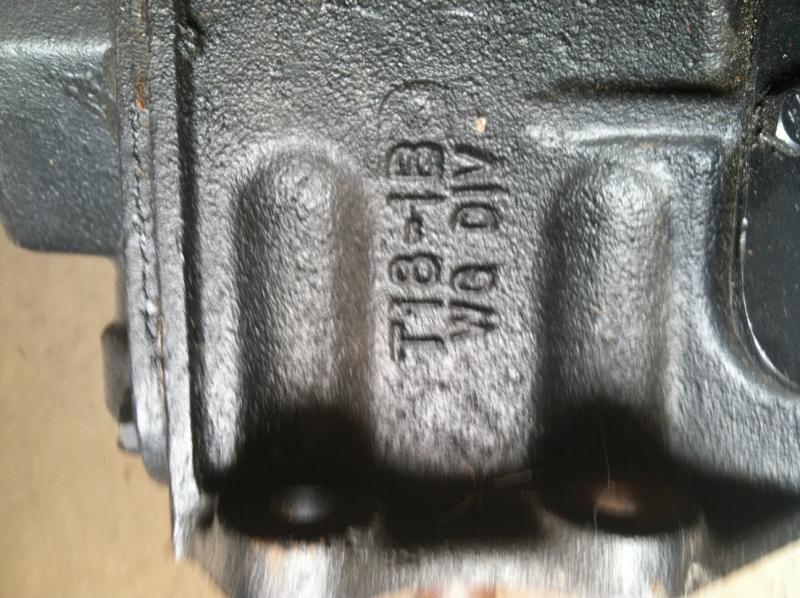

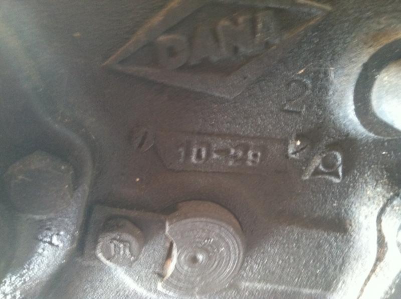

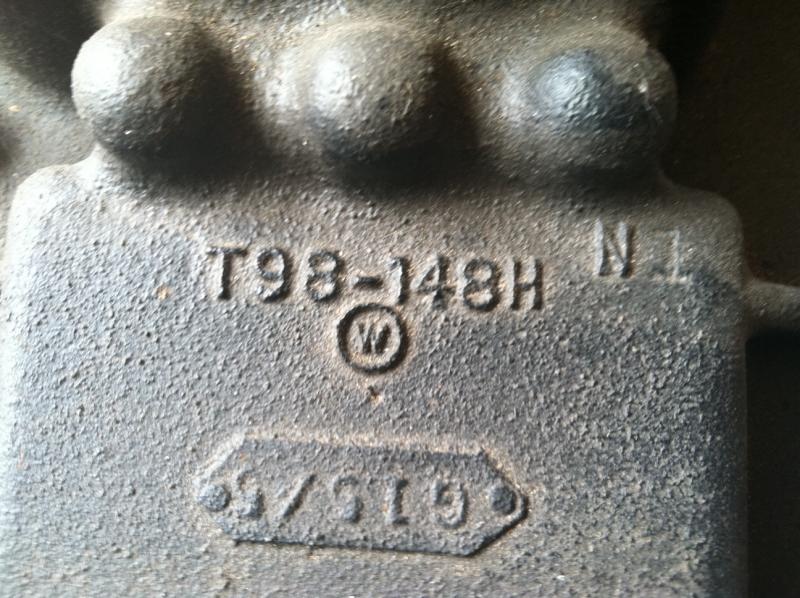

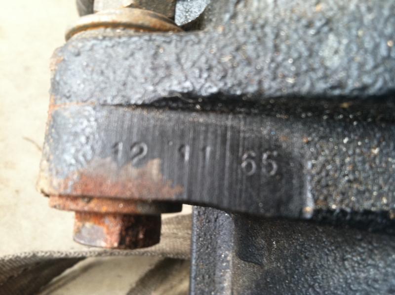

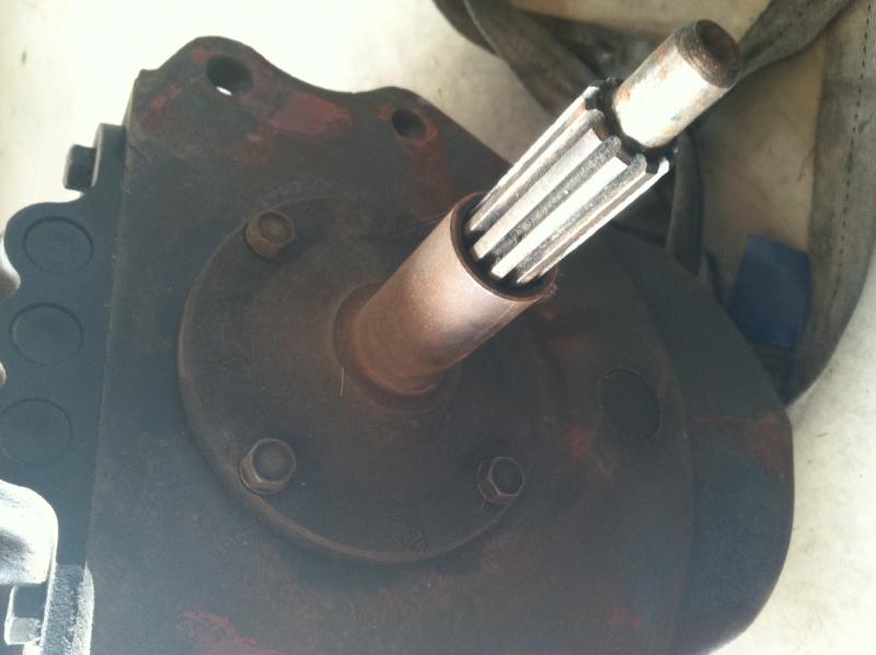

I have a few pictures of the numbers on the trans and transfer of the t18 I have. I finally got a camera on my phone that works. Im looking for some information on the trans and transfer numbers. I dont know if there is a better option for this trans, it will be coupled to a 196-800 Jeff if you are reading, im hoping this is the information you needed to get the right cv joints on my order, if not let me know and ill try to accomodate.

I know a bit about t18. What I've been told is that one will have a 4:1 first gear. T18a has a 6:1 first. The '82 honcho I'm repowering with a 304 5 speed currently has a 360/t18a/NP208 31 spline input and fixed yokes fore and aft.
I'm selling the original drivetrain but didn't post it here due to it being Jeep and not ihc. Wouldn't be of use in an IH since it's drivers side drop.
