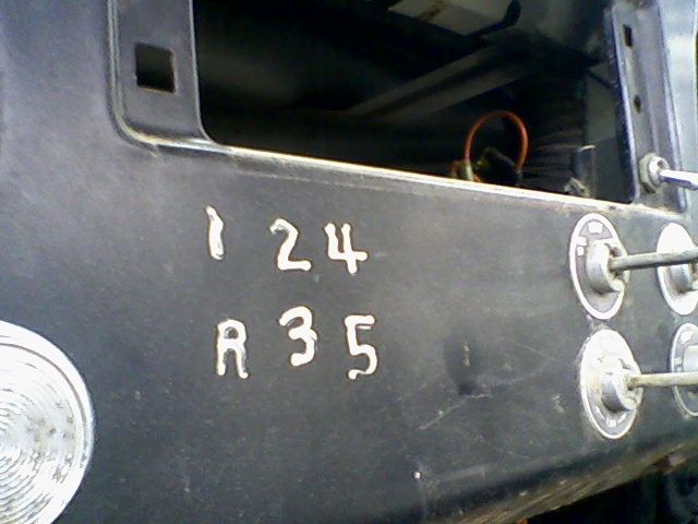

Working on a transplant, shifting the transmission, it feels like it has 5 gears plus reverse. Are t-98s 4 speed or 5 speed ?
With that shift pattern you would have a IH 5 speed either a t-34 od t-35 wide or t-36 close. Is this a Scout/Travelall/or pickup? If this is a Scout, then someone went to a lot of work.:winky: the t-98 isn't a 5 speed
Based on dash picture, it is a loadstar or some other "large" IH -- defintely not a Scout / traveler / pickup / t/a -- with a t-35 / t-36.
Wrong shift pattern for a t-34 (od) -- if diagram on the dash is correct.

It is a 73 loadstar I got for $375 b/c the pinion is broken. Came with a ic 392 and supposedly a t-98. I am installing in a 68 1200c. The awd 1200c has a 4 speed in it but I was hoping to upgrade to a 5.
That shift pattern is for the t-35 and t-36, not! For the t-34od, the t-36 is the better of the two for towing, it has that "magic" gear every one wants between third and fourth in a four speed, the t-35 is really nothing more than a close ratio four sped with a granny gear added.
The shift pattern painted on the dash is correct for a t-35 / t-36 as goldie states.
