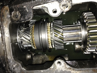

I opened up the transmission and everything looked perfect, shiny, and new. No teeth missing, chipped, or cracked (see attached pic).

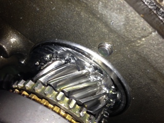

Took a second look and noticed that the front imput bearing is thrashed (see attached pic).
So it looks like in addition to the motor swap I'm going to need to do something about the transmission. Do I rebuild the t-90 for cheap ($400) or invest in finding and then installing a 4 speed with the pancake bellhousing installed? Tough call since I can't do the fab work for the 4 speed - but can do the t-90 install.
