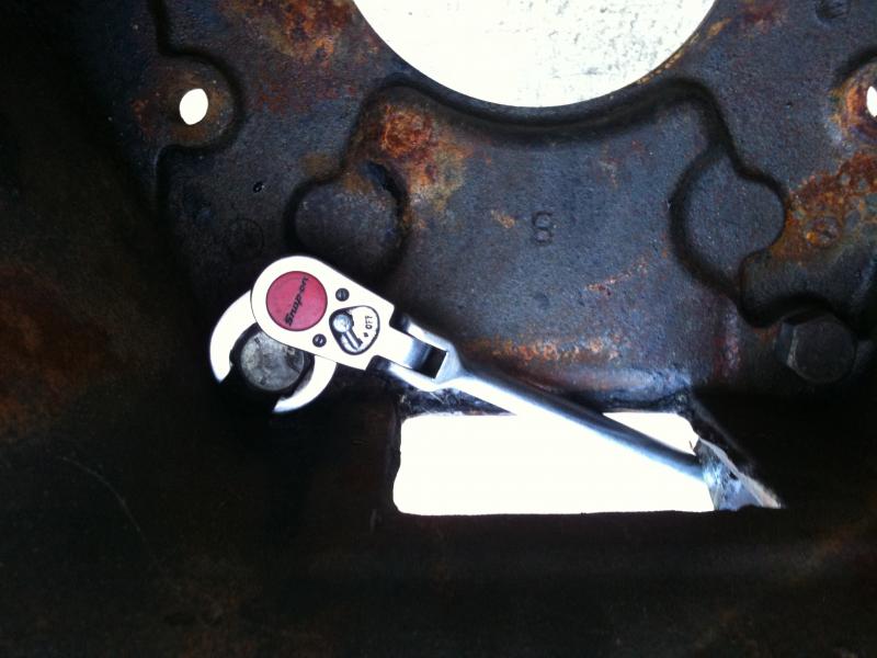

I have performed this swap into my 1964 c1200 4x4, 304 v8 pickup truck. Donor truck was a 1971 d1200 4x4, 392 v8 Travelall. I have read all the threaded replies to the op (as of 21-dec-2012), so I will try to avoid duplication of information other than to clarify from my own experience. I believe this to be an IH t-36 transmission. 5th is direct, and 1st is approx. 6:1 gear ratio, as determined from counting input vs output shaft rotations before installing.
Clutch and flywheel:
I kept my 304 flywheel (flywheels are usually balanced for engine types). Used the 392 clutch disc and pressure plate ass'y as they were in better condition. Both are 12 inch. Both release bearings & collars were identical. I used brg & collar from the 392 as they were in better condition. From this you can deduce that the 4sp and 5sp input shaft diameters & splines are identical, but the pilot bearing dimensions are not.
Pilot bearing:
4sp vs 5sp pilot bearings are different. 5sp is larger, and my 304 flywheel had a factory spacer which, when knocked out, allowed for the correct pilot bearing to be installed (which was a 207 as I recall).
Bell housing:
4sp vs 5sp bell housing is different in two ways:
1. 4sp attaches with 4 studs; 5sp with 6. Engine sides of both are identical.
2. My clutch is hydraulic, and 5sp cross-shaft & bore are wider than 4sp shaft & bore. I used the 5sp cross-shaft with it's "dog leg" actuating lever which connects to slave cylinder. The dog leg compensates for the added width of the shaft. I made no changes to slave cylinder or its mounting.
Cross member:
I did not change the cross member. The c1200 and d1200 appear to be identical. I did use new IH bell housing to cross member mounts.
Transfer case lever bracket:
I tried to use the odd-shaped right-angle oem bracket from the Travelall, but I wanted to retain my original lever (that hulking cast steel lever from an old IH corn harvester I think). This would have put the lever in the wrong place with respect to the oem hole in the tunnel. I ended up using the original 4-speed bracket by measuring carefully, then drilling and tapping two 7/16" nf holes into the side of the transmission for bracket support. I used two 7/16" x 1/2" spacers between bracket and transmission to distribute stress and allow for lever movement. The previous owner had used a cutting torch to enlarge the tunnel hole for some reason (it's ugly, see photo xferhole.jpg, which shows the bracket positioning mockup prior to drilling and tapping). I was able to get the lever into roughly the oem location for this truck. Someday I will fabricate a small panel & weld it in place, meanwhile it works ok covered up with the floor mat (I live out in the sw desert so rain is not much of a consideration but snow is).
Transmission to body clearance:
the top (aka "shift tower ass'y") of the 5sp interferes with the tunnel cover on my 1964 c1200. The Travelall cover is a different animal. I fabricated a "trim ring" out of layers of plywood, and used this arrangement to raise the stock cover approximately 3/4 inch. I used longer ss screws to hold it down. This gives ~ 1/2 inch clearance in the tight spots, and I've yet to hear any banging/scraping. You can't see the additional height with the floor mat in place (see photo 5sphole.jpg).
Other considerations:
* I did this transmission swap in my driveway.
* 5sp is a heavy brute for a 3/4-ton pickup, around 250 lbs. I bought a transmission jack adapter to use with my hein-werner shop floor jack (made in usa). Safety first!
* transmission bolts to bell housing via 4 upper bolts thru trans flanges; 2 lower bolts thru housing. The latter are difficult to access thru bell housing vent. I used a 1/2-inch drive 7/8" crowfoot wrench to loosen/tighten (see photo crowfoot.jpg). Only workaround is to r&r trans with bellhousing attached, but that is too much weight/acrobatics for me on driveway. Note that lower left trans bolt (driver's side in u.s.) is thru bolt & you will release all the trans oil with this bolt. I used thread sealant for install.
* the jackshaft was shortened by approximately 4.5 inches & balanced.
* 5sp holds around 1.5 gallons of oil. I always use gl-1 mineral oil in truck transmissions and transfer cases (not hypoid).
* transmission has been in truck for 2 years now, and I love it. With that 304 and my vintage alaskan popup camper in the bed (camper weighs approx. 1700 lbs dry), having the closer ratios (closer than the 4sp) are great for on- and off-highway hill climbing.
* my 1964 c1200 4x4 now sports an oem 5-speed shift knob with a 5-speed transmission on the other end! I have yet to see another c-series pickup like it.
I also pulled the Dana 44 hd (large closed knuckle) axle out of the donor Travelall. I kept my 1964 c1200 oem 6-lug wheel pattern after the swap (donor truck was 8-lug). I can post my experience with swapping that into my 1964 c1200 if anyone is interested.
-- max.
