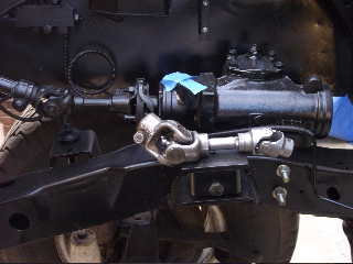

This is how it came out. The spicer u joint (#5-92x) went into the stub shaft assembly from my '74 sii. This and the borgeson joint should make for much better handling on the '79 (pictured). The original column joint in the pic is super wobbly and not re-buildable. And even a new rag joint will eventually let you down. I love new parts!
