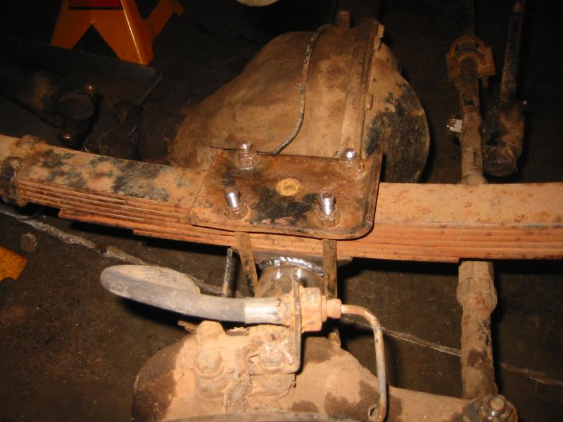

For those of you who are on the fence about what to do about lifting your model 80 or 800.... I found this spring over axle lift to be super easy and it didn't cost me a dime.
I used all the existing hardware, although I would highly recommend buying all new u-bolts and u-bolt plates, a nice drop down pitman arm, and a new drop down brake line to anyone who was doing this lift. I was just on a super tight budget so I used what I had.

If you click on the facebook link above the photo you can see in more detail that I did have to lengthen the front drive shaft...
Even in the photo here you can see that the u-joint doesn't quite reach the yoke... By about 3 inches I think...
