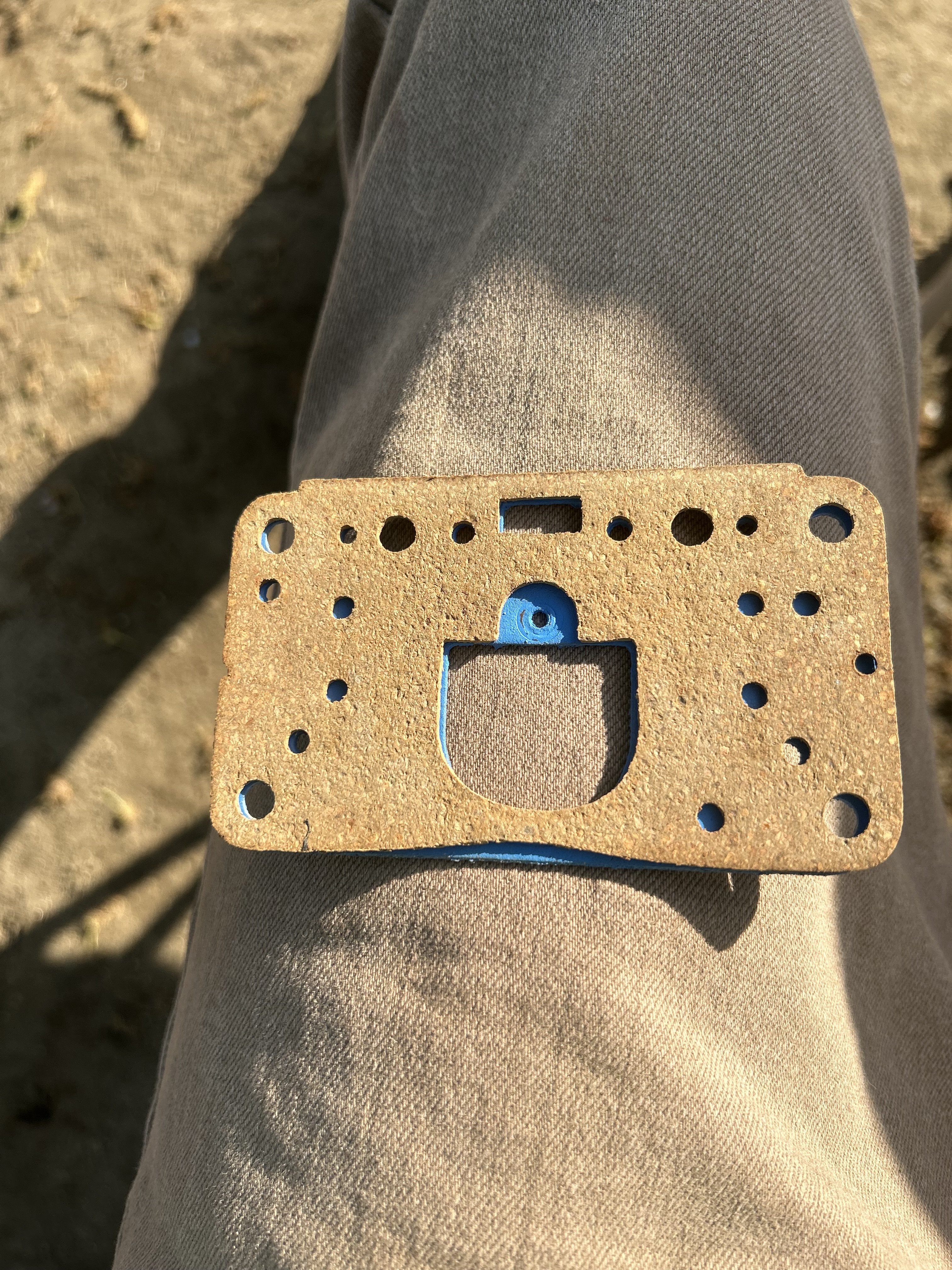

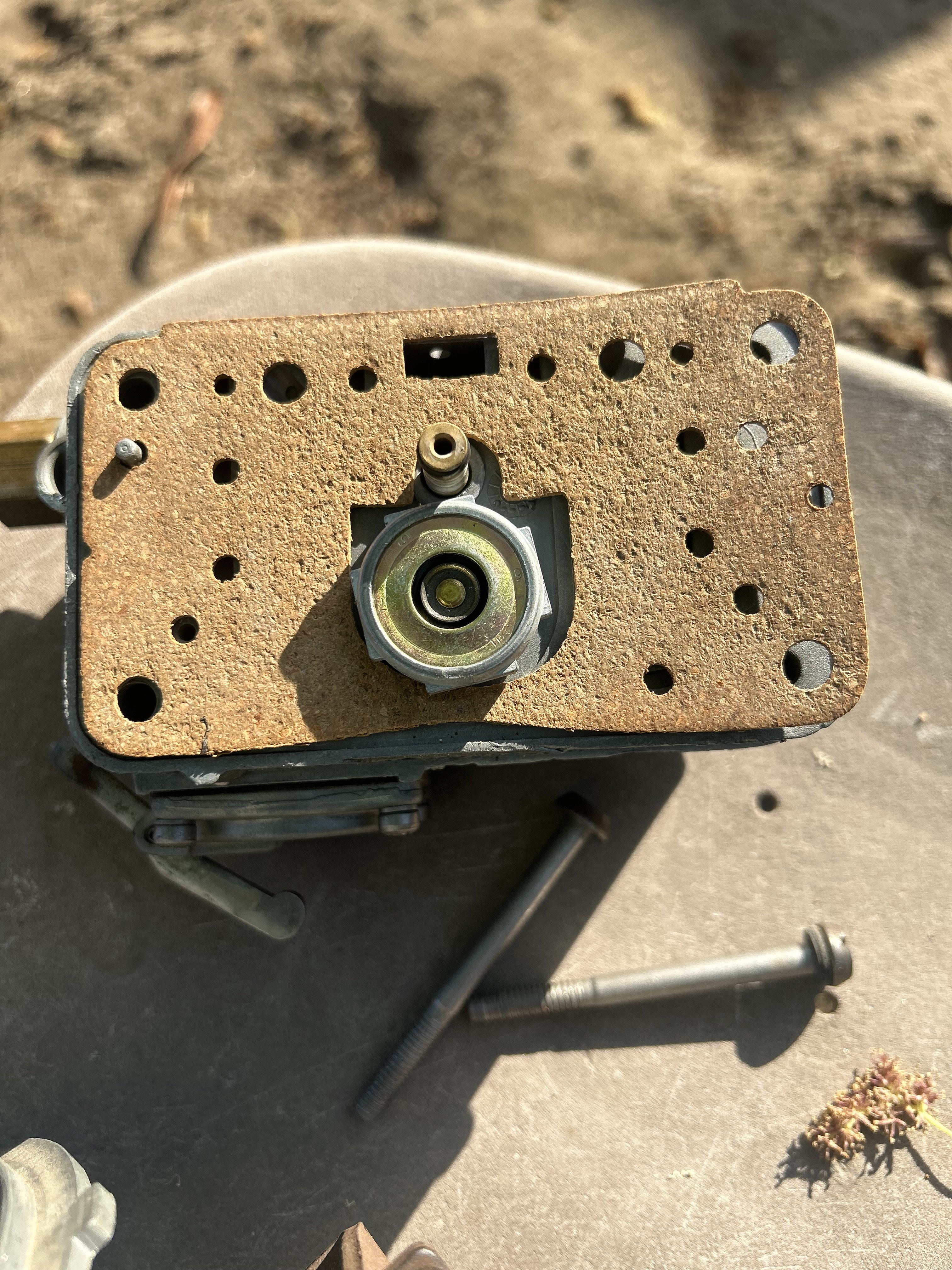

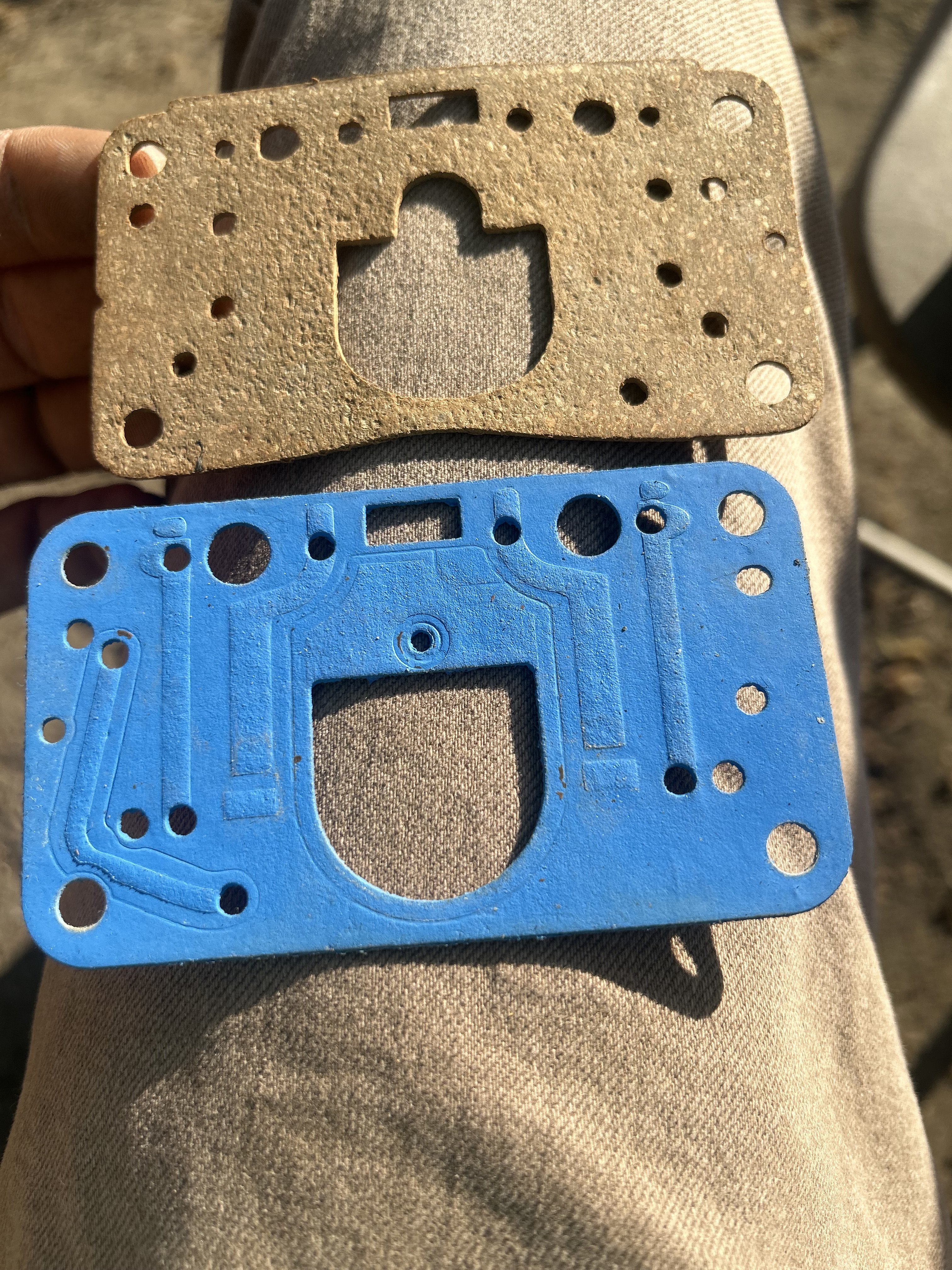

I’m ges swing this is why it leaked so much from bottom of carb, I replaced with new gasket I will report again later today after I test out carb with new gasket

new gaskets on Holley carb no more gas leak, and going to run compression test later today, thank you very much guys I’ll report with reading when I get to it,
