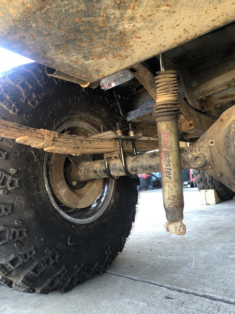

Hi all, I am looking for some advice. I just recently purchased a 73 scout from out of state to bring it into CA. There was a SOA partially done on the vehicle.
So here is my dilemma. The bushings are shot in all 4 springs. I also don't love the height and would love to drop it 2-3 inches. So I am considering custom springs.

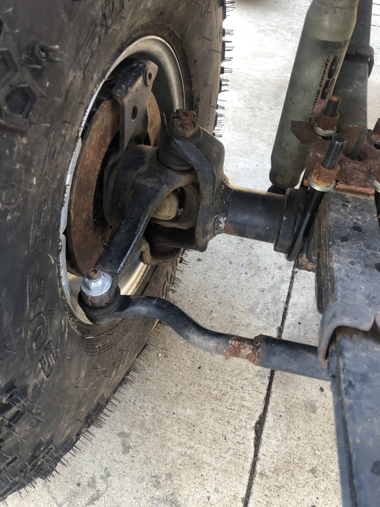

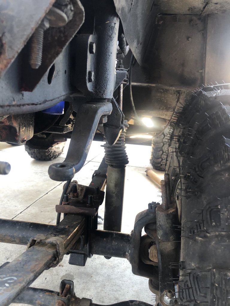

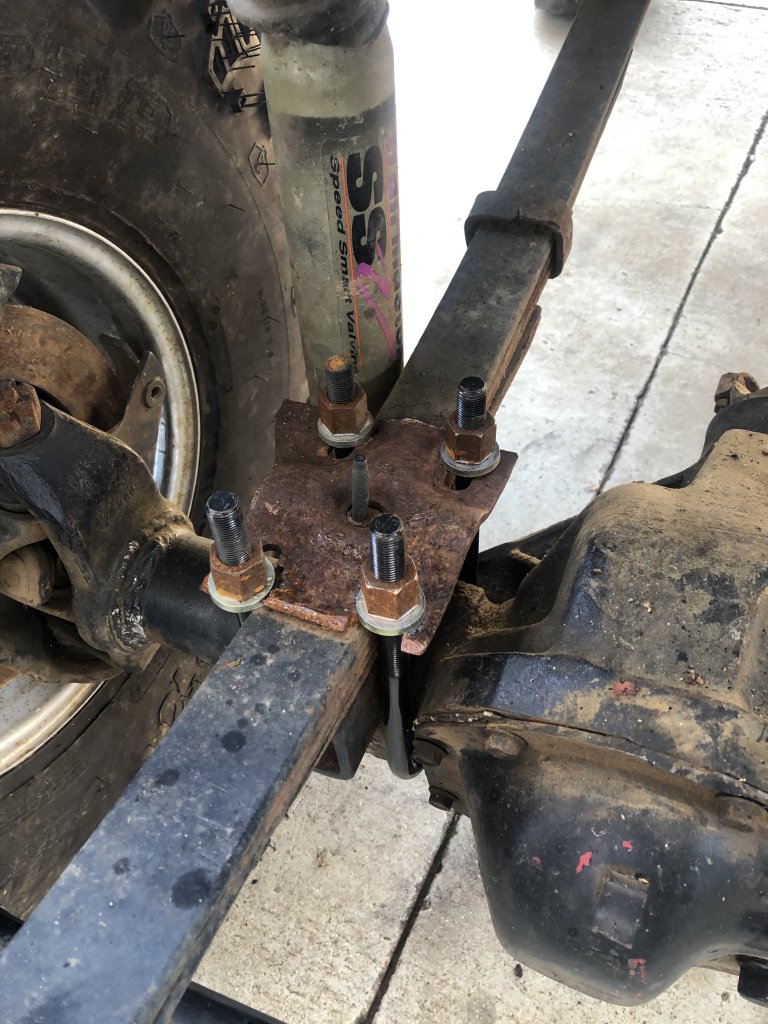

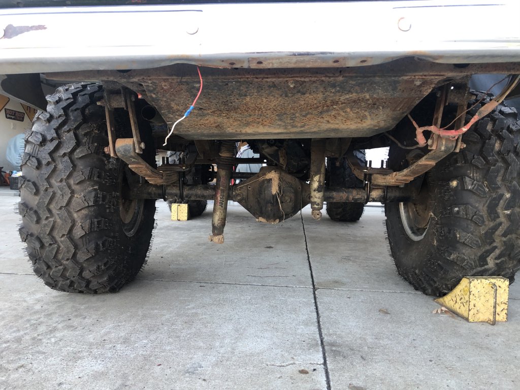

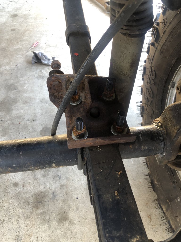

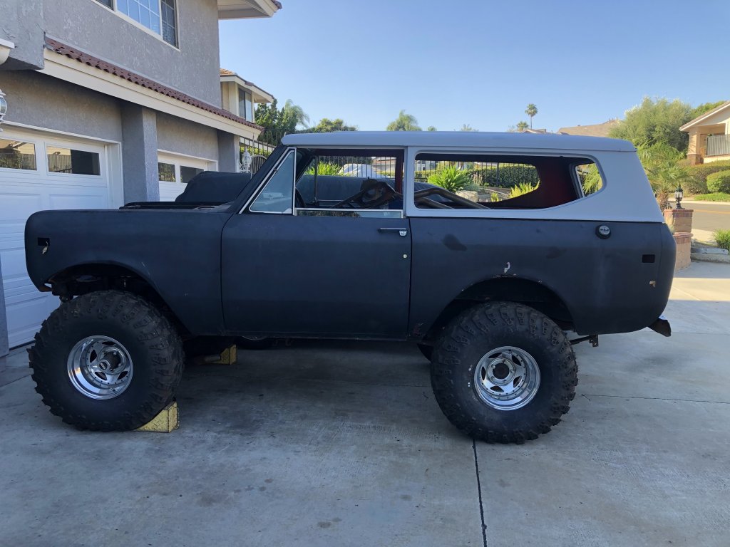

I have attached photos and would appreciate any advice you all can give, and before you all jump all over me I'm not a gear head, but love the trucks. I have a master mechanic working on this for me. it's non-op at the moment.
I do like for now the truck with 37's and plan on driving them around. This is not intended to be a crawler - everyday with some light offroad.
73 scout ii
350 chevy with TH350
Transfer case - unknown donor vehicle
Dana 44's front and back from a Scout ii (from what I am told)
37" tires

Also looking for recommendations on shocks as well, or anything else you may see that would make this better to drive.
I'm far from an expert, but the rear shackles and shackle angle just look wrong to me. Also, I'd say you have a very questionable U-bolt plate up front. Looks to me like the bolts could "walk" out of the plate? Fixing those 2 problems could result in some improvement.

Got a better look on my desktop. Wow bad case of PO (previous Owner) virus there. Like Codeman said, don't run that front shackle plate, that along with those tie rod ends are an accident waiting to happen.

Yeah those plates are super bad. I am wanting to purchase new ones, but now that I need new bushings or new springs I wanted to wait until I purchased it all together. I was shocked when I saw that as well.
agreed. thats why I am wanting all new to get this rig driving correctly with a SOA setup.

Do you have photos of your truck? Would love to see it.
Also if I go back to stock springs do you think my 37's would still fit? I was told by IHPartsAmerica that they thought I had a sagging 4" spring that was roughly 2" of lift.
37s would fit with a bit of cutting. Also moving the rear axle back 1-2".

Okay well I have finally made a decision as to too many unknowns and issues - I am looking to swap out or sell and replace the Dana 44's SOA conversion and go back to a stock setup with a 4 inch RC spring lift and 5" shackles. I think the gearing is 5:18s or larger - this would kill me for a daily. So parting ways with the 37" super swampers as well and going to a 35". Both front and back are disc breaks, posi, and SOA currently.

I was just looking at your photos. Man, there be some P.O. hack work there. I have had to deal with a lot of that with my 73 beast. For a good read, I have a build thread on here. Links list in my profile signature
