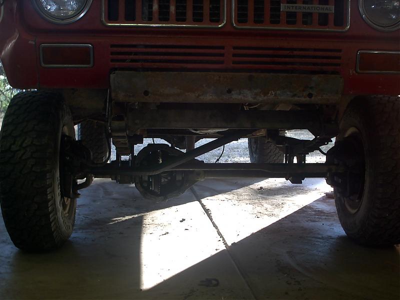

Was looking at my front end this evening after work and looking at my SOA I have made my perches up higher than I have seen other applications. My concern is that I May have put them up to high for me to put a high steer arm on. Is that possible and/or are there options for me? This is the best picture that I have right now. I believe that we made them about 1 1/2" top of perch to top of axle tube.:confused:

Its going to be tight but you might make it work with the partsmike super hysteer arms and 1" tall spacers. You are also going to need the longer studs for this set up as well. If buying new knuckles I suggest going with the partmike knuckles as they are 1/2" taller where the arm bolts up to compared to a stock knuckle.

Super arms with 1" tall spacers, long studs, cones and nuts will run you $356 plus shipping. Again no guarantee that this set up will work for you since you have very tall spring perchs.
