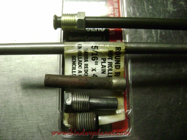

Working on a pair of 345 heads: noticed that there are straw sized tubes (about 3.5 inches long) inside the exhaust port. I figure these are the air injector smog tubes. The ones that I see look pretty much corroded. Where do I find replacements? Any ideas?
I know what you mean. It's the middle one in this picture. I'd call IH parts and see if they can get 'em. I May have some used ones if new aren't available.
I'm guessing you have to smog? If not just plug them off.
My '74 Scout, no kidding, from the factory came with the tubes installed under plugs and the smog pump plumbed straight into the center of the exhaust manifolds on each side. I don't know what that accomplished except as a check off that the smog controls were installed.
