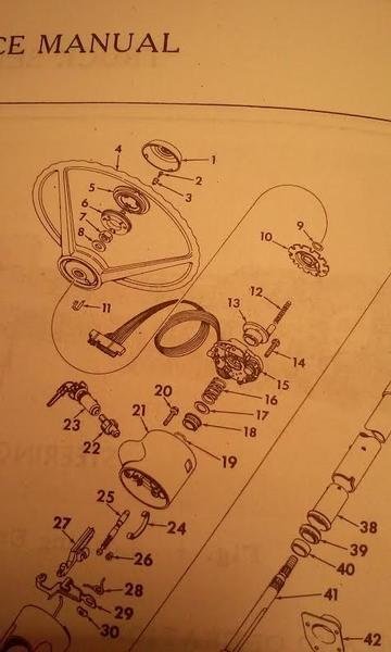

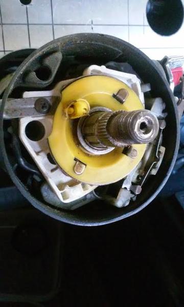

Ok so I got the steering wheel off finally and noticed in the service manual there is a plate that should be right behind the wheel and held in place by a snap ring, however mine did not have that plate only the plastic housing with the horn spring. It does look like the snap ring is there holding it all on the shaft, so the question is do I need that plate? What is the purpose for that plate? How in the heck can I depress the spring behind the plastic piece without destroying the 40 year old brittle plastic...
Here is what I am working with

The purpose of that plate was to lock the steering wheel. Don't understand exactly what the issue is with getting the snap ring off.

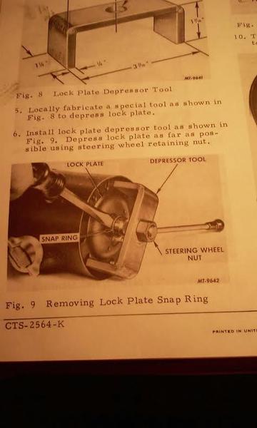

In the manual is shows depressing the plate down so the snap ring that sits inside the collar can be taken out, I don't really want to depress that old plastic on that stiff spring it will crumble. So I don't necessarily need that plate or what?
This shows using that #10 labeled plate to depress on the spring inside to get out the internal snap ring.

If your Scout II steering column does not have the lock plate, then I would assume you have a tilt-wheel style column. Correct?? Tilts don't have the lock plate.
The Scout II uses the saginaw column, as used in millions of GM autos/ truck of the same period of the Scout II, and later.
Disassembly is similar to the standard column, but you need to take extra precaution to not damage the plastic parts.
