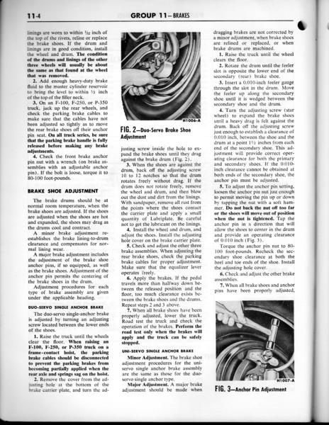

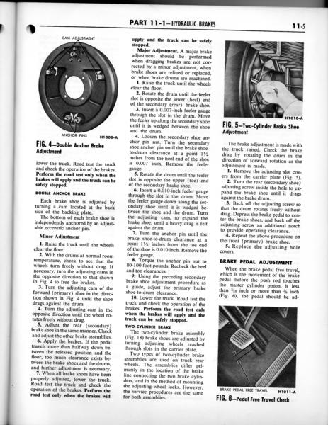

Here's a page for the adjustment/anchor pin deely Bob:
the eccentric at mid-point would probably be for a twin leading shoe or lead/trailing shoe depending on the wheel cylinder action. I've included that picture also in case someone has an old truck with that setup. My 48 has the twin leading shoe and they are extremely easy to foul up the settings as the "expert" who assured me they were professionally overhauled did when I bought it.
Greg,
I just today, due to over 3 weeks of the flu since going to visit family during Christmas, began again to get into the brakes on the s120. Right off the bat I discovered the problem.
The eccentric adjustments at the top of the backing plates on both wheels were adjusted so that the front shoe was too close to the drum at the top. When the wheel cylinder pushed the brake shoe forward only the very top of the shoe contacted the drum. So, the servo action was almost non-existent.
The rear shoe was making full contact during braking and has worn very evenly heal to toe. But, since the front shoe was not engaging the drum the "servo" action was not augmenting the power of the brake. That is why I felt the brakes were so under powered requiring very high leg pressure on the peddle to stop the vehicle.
The trailing edge of the front shoe, when the brake peddle was depressed, was more than a quarter inch from the drum (so far that I actually couldn't see it through the drum slot). The brake adjustment at the bottom could not adjust the shoe to engage the drum because the top of the shoe was too close.
I am saying things that you already know, but I am adding detail to help those not familiar with the single servo system.
While things were apart, though the old shoes were in pretty good condition, I decided to install new shoes on the front axle. Several people have said that these old shoes were no longer available. Well, I had no problem getting shoes at very reasonable prices.
Clearly the mechanic who previously worked on the vehicle was unfamiliar with a system using a single servo. If you guys had not reminded me about this, I would have likely continued to treat the adjustments of the system as if it were a double servo.
The brakes work so spectacularly well now, I have abandoned my intention to add a vacuum booster to the system. The stopping power now is as good as power brakes (but, I am going to install a split/dual master cylinder for the safety factor).
