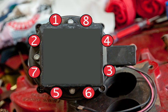

Okay, I just wanted to verify the firing order visually. Someone please sign off on this.
attachment.php

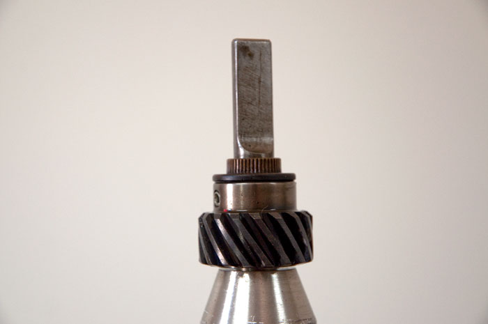

And the oilite bronze bushing...
attachment.php
What is the best way to 'seat' this puppy?

For the plug cable orientation in any distributor cap, #1 can be any hole ya wanna make it, that depends upon the exact position the distributor is stabbed in to begin with.
So ya first need to stab the distributor as described in this thread:
http://www.forums.IHPartsAmerica.com/ignition-tech/640-new-guy-clueless-about-ignition.html
We must use cylinder #8 as our reference point because of the design of the crank hub that contains the timing Mark. And cylinder #8 must be on it's compression stroke, not exhaust stroke. That is real easy to visually identify if the valve cover on the passenger side is removed for observation of the rocker arm positions for cylinder #8.
Then...you determine which plug cable terminal is #1 and then wire the cap in the firing order sequence, that distributor rotates clockwise when the engine is running.

As for the bushing...good thing ya found that!
You can see the serrations on the circumference, the bushing was originally just tapped into the receptacle in the block when it was new and the serrations "crushed" enough to retain it. What I do on the bushings now is clean 'em to a point of sterility (same for the hole in the block), and then use loctite red on the bushing and push into place. Once the distributor is stabbed, the bushing cannot move.

Gotchya, thank you for that...
I believe I now have a much better understanding of what needs to be done now, and why.
I had my wife watch #1 piston come up in the cylinder while I turned it over slowly by hand and then stop me when it just began to go back down. My plan was to stab the distributor and identify the contact the rotor lined up with as #1...
But, I now realize that I don't know if this is the compression stroke or the exhaust stroke as the crank hub/timing Mark are no help because I'm looking at cylinder #1. Right? Lol. I know just enough to be real dangerous, so thank you very much for filling those large Gaps.
Yes, I had this dui distributor installed on my 345 and it is a pita initially, but once on there, it was nice for someone with my limited experience level to just sort of plug and play and have it work. I called performance distributors today to make sure that I wouldn't have any problems using this same distributor in this 392 and they said it should be just fine, no problem. I'm also going to install my temp sending unit into the water neck 'extension' this time around so I can get my temp gauge back. They really should come that way. Imho.
Yes, my coveted bronze bushing. I put this in a safe place when I first found that it had come out when I pulled the distributor. I read the other posts about how important it is, and I thank you for the info on how to properly clean and seat it.
Thank you yet again mr mayben. You are a gentleman and a scholar.
