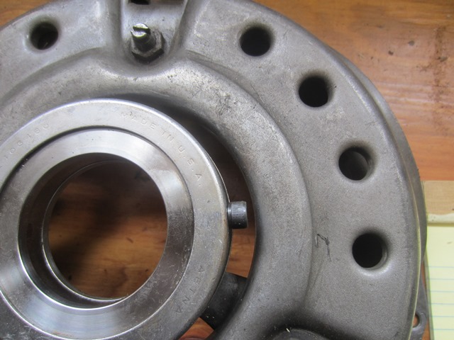

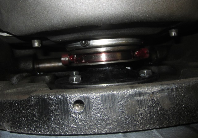

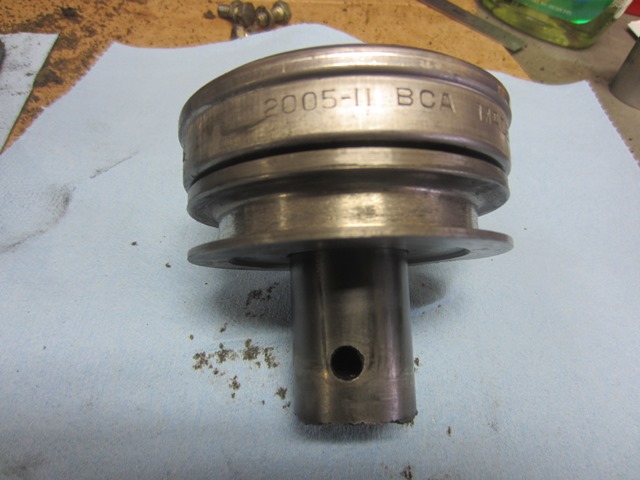

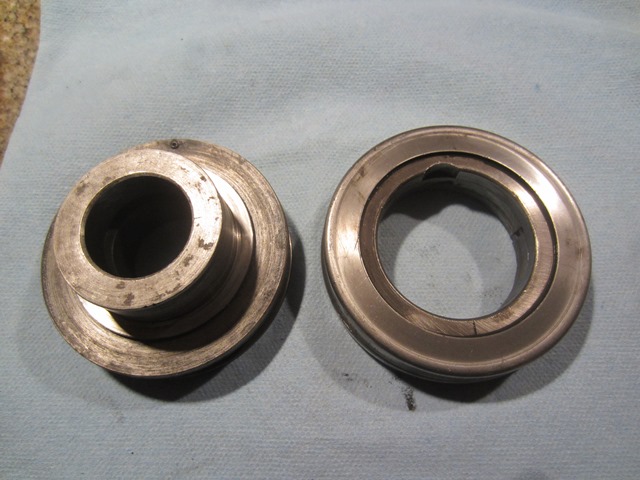

I am in the process of repairing my clutch/transmission/throwout bearing and want to make sure that I install the correct throwout bearing. I have read many posts about greaseable and non-greaseable bearings and am confused. Hopefully with some pictures I can clear up the topic. I have an inkling that what I took off is not correct.
First off this is for a Scout 800 with a 152, t18 and Dana 20. Attached are some pictures of the removed throwout assembly. It is obvious that it is a non-greaseable unit, there is no grease zerk. However, looking at the bearing, it appears that there is an opening to the innards that would be positioned on the “inside” of the assembly. I have read that having a greaseable bearing on a non-greaseable sleeve (collar) is a no-no. Makes sense, because there is no way to grease it.
I have also read that it is possible to make the sleeve (collar) a greaseable unit by drilling a passageway and installing a zerk. A picture or better description of this process on a sleeve like this would be very helpful. I think most of the posts are about Scout II/v8 throwouts, which are apparently a very different setup. I have also read that you could drill a small hole in the side of the bearing in order to get some grease in there. What bearing do I need to work with this collar?

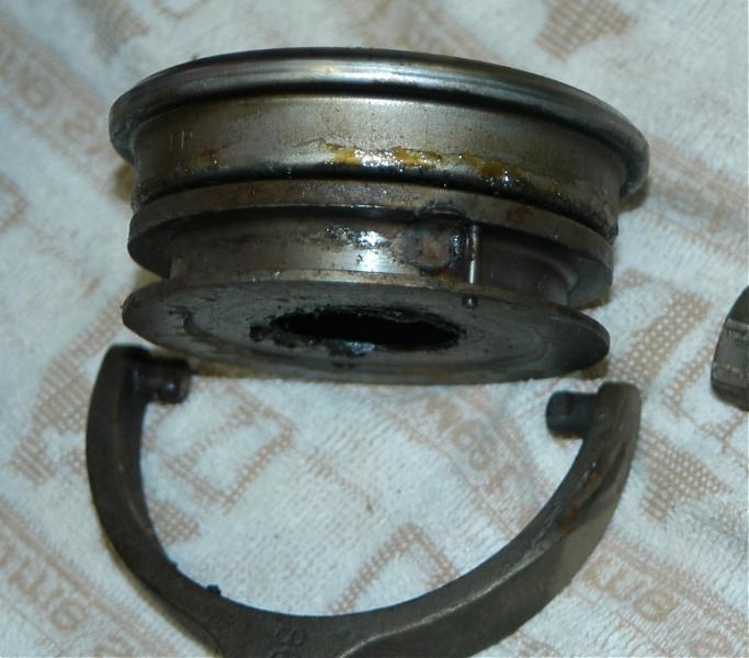

Also, on my collar there are two holes drilled and a broken off roll pin. I found a photo of the same sleeve with the roll pin present. Does anybody know what the function of this roll pin is?

The pin is necessary to keep the collar from rotating and wearing the fork tabs off...
As far as I know there is no geasable collar for the 800/80 nor is the bearing itself greasable. They are simply replaced.
Be sure to grease the collar and retainer liberally before installing.

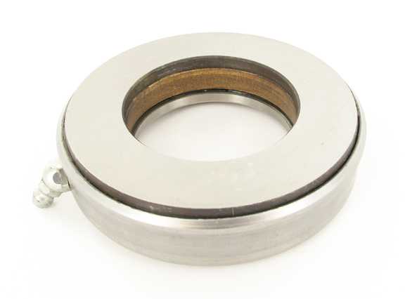

I believe have figured a way to have a greasable throwout bearing on an 800 with a pancake bellhousing.
I ordered a n-1610 bearing which is a greasable bearing with an angled zerk. The zerk would contact either the fork or the clutch body depending on how it was aligned. A straight zerk was also too long to clear the clutch.
After lubing the bearing I removed the zerk and capped the threaded hole with a short allen head cap screw and a little blue locktite.
The manual calls for lubing the bearing every 10k miles. I should be able to remove the cap screw and insert a straight zerk to lube the bearing.
