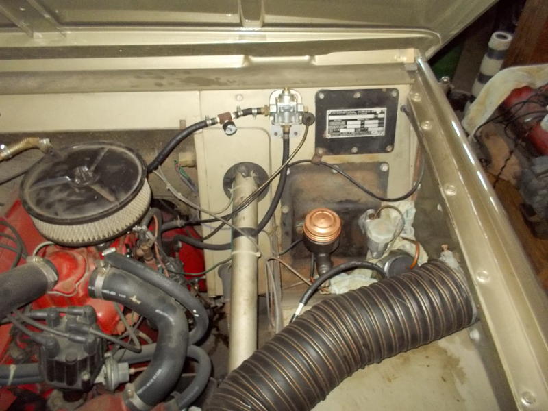

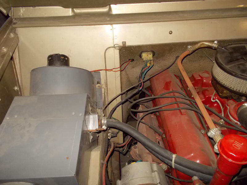

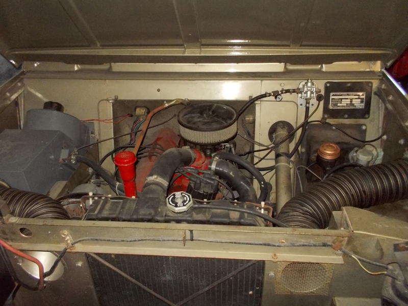

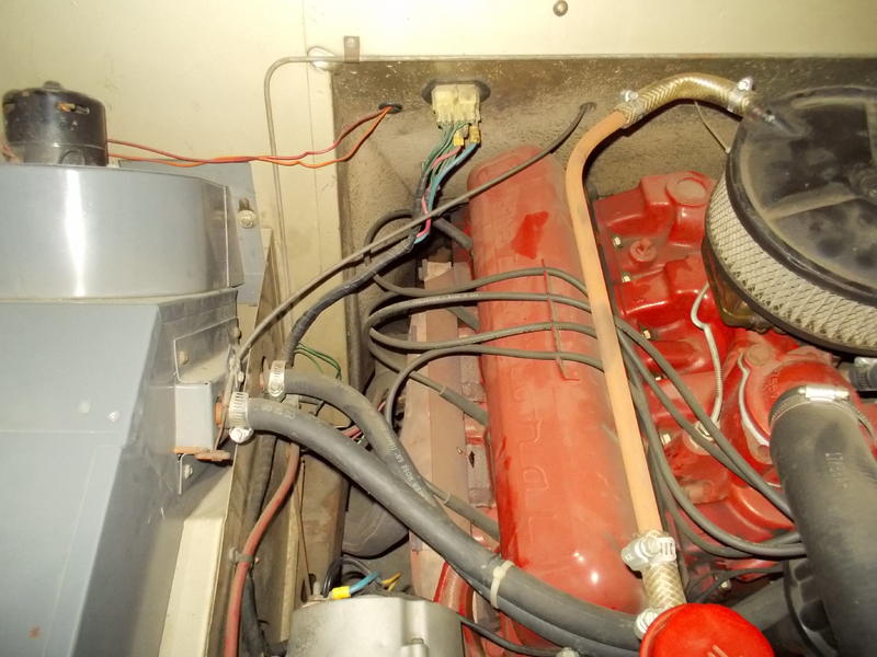

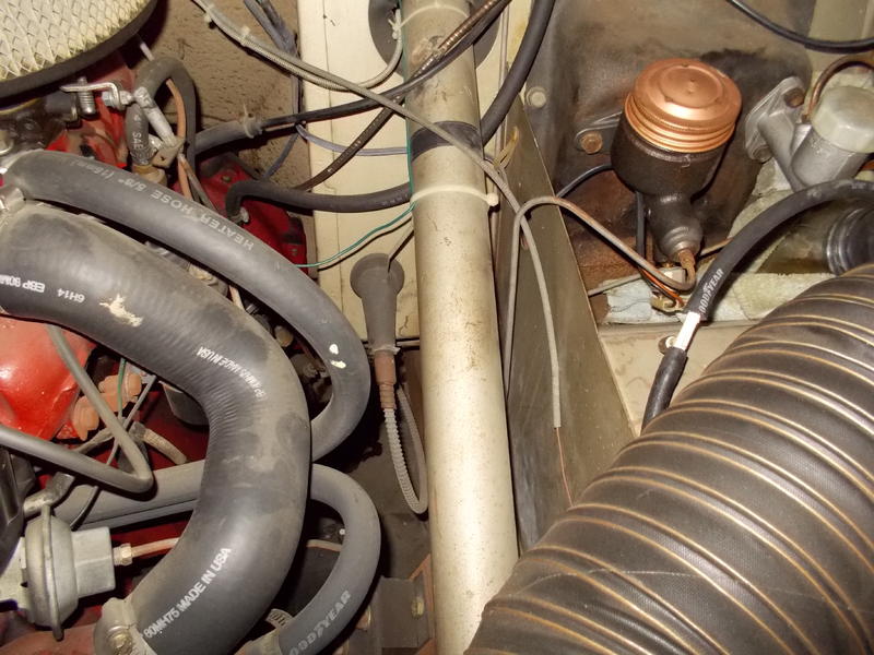

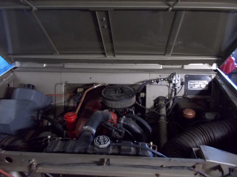

I'm in the middle of putting together my 1964 Scout 80.. Can anyone out there share some pictures of the firewall from the engine side.. I need to figure out what goes where.. So detail would be greatly appreciated.. There's so many holes and I want to get it right. Thank you for the help.
Will a 65 do? If you have any specific details I can make sure I get them.
