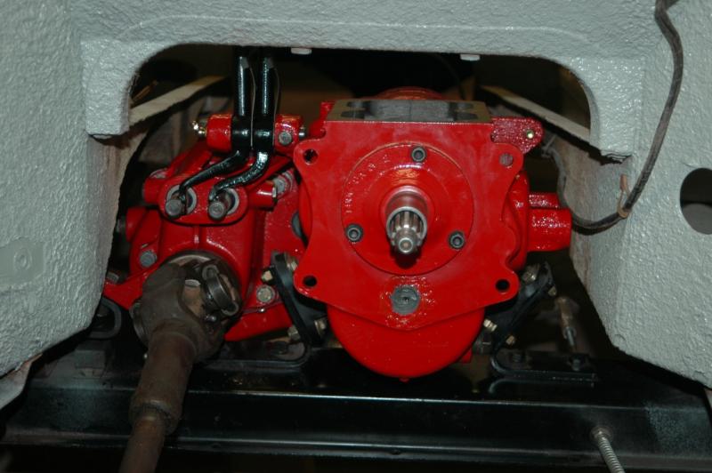

Thanks for writing back so fast. The guy is telling me that there literally isn't space for 2". He's essentially saying that the space is exactly 2" and if he went down to 1.5" he'd have 1/4" on each side for clearance. Is the difference to do with the bumpstop thingy I have on the t-case? I can't tell for sure if it's there in your pic michael, but it's clearly visible in the attached pic (lower left, painted black). I think with that gone there'd be a lot more space.
I told him to just clear the tire with the factory routing for now. I'll go back later if I decide to install some rocker protection.

My rig does not have that extra snubber mounted.
It's my understanding that part was used only on vehicles equipped with a pto, but I haven't confirmed that.
So it's obviously in the way of running the exhaust pipe over the top of the crossmember.
Interesting. I went through two crossmembers so far and they both had the rubber stopper thing on there for the t-case bumper. It doesn't really seem necessary, but it was there so I reinstalled it. My tire isn't rubbing now in any case, so I'll live with the factory-ish routing until I have a reason to change it.
