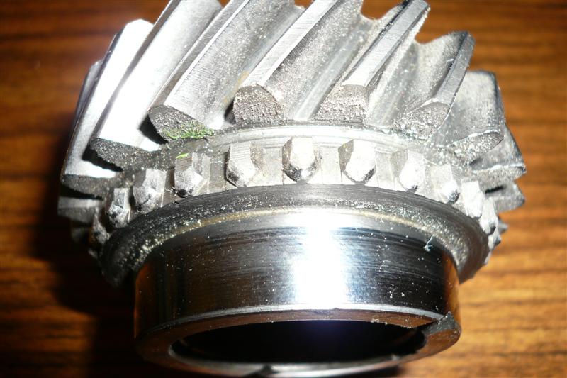

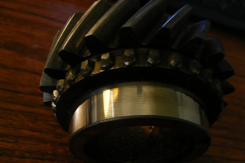

Pictures on 2nd gear tooth damage. The pollished tapered surface is where the syncro ring rides and has to grip to syncronize the tro shaft speed differencials. The shiny surface needs to be deglazed with 200/400 grit wet dry paper if reused. I expect to see the same in your gear box. Sorry I can't find the other parts. Must have hid them away for some reason. :out:

So 2nd gear is the one that takes the abuse? I've been looking into a rebuild kit for it and I would guess the ones that come with a new 2nd gear would be the one I should get. I have a jy trans/t-case sitting on the floor, guess I'll go through that one and trade. An IH t90 is a t90 right? It came out of an 80, so it should be the same trans....am I on the right track?
The second gear and the clutch hub both get beat up the same especialy when the syncros lose effectivness. Take the top off and you can do a fair amount of inspecting so you can get what you need.
Bearing and seal kit should be east enough for Jeff to get but hard parts like gears won't be so easy. The t90 under went a syncro redo some time during prior to 65. The rings for one version are hard to find. Sorry but I don't have my info with me. Hope another member will pipe in. I remember the Scout gear boxes had differences from the Jeep ones
