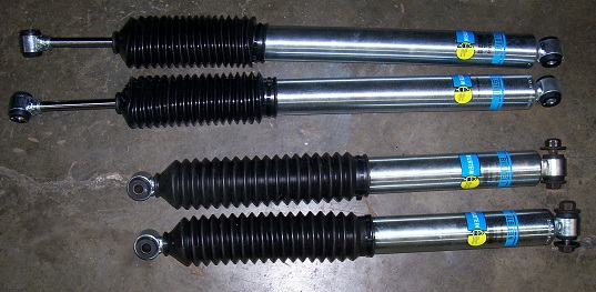

As mentioned before, Bilstein shocks are a great choice. Reservoir or not, they work awesome. When I did the SOA/lift on my 74 Scout, I ordered up a set of four from IHPA. No reservoir type shocks. Handle great, both on and off road. Here's a shot of what I received a few years ago.
