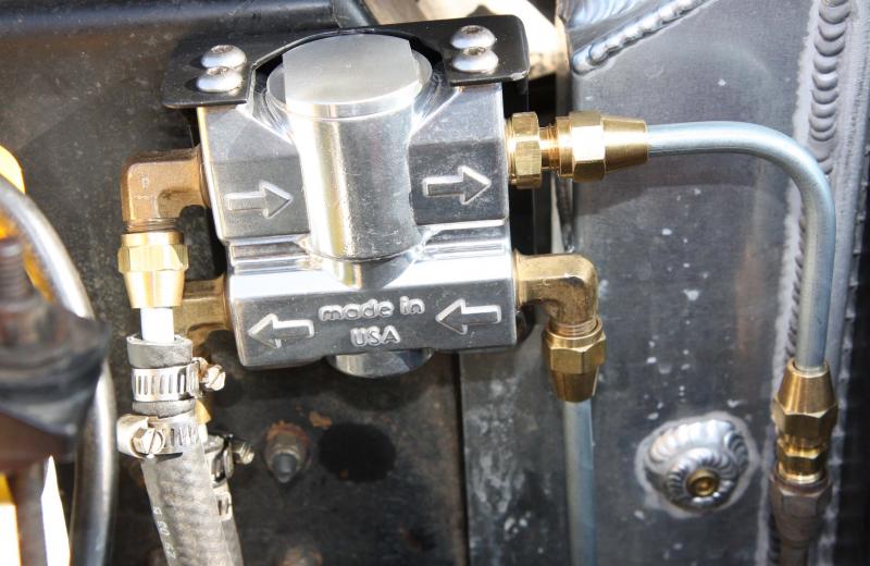

Ok, it took a couple of weeks but I have the remote thermostat installed. I welded up a bracket to mount the thermostat to the radiator support. I plumbed it into the existing hard lines and should I ever need to reconnect to the radiator cooler circuit it's a ten minute job. As it is I'm only using the hayden cooler (#679) behind the grill. As the derale thermostat (#13011) approaches 180deg the valve begins to close, sending the fluid to the hayden cooler. I drove it on the freeway today at 55deg ambient and the trans temp sat at 155deg. What I've read indicates that the valve is open, with minimal flow to the cooler until about 160deg. At that point it begins to close, being fully closed at 180deg. I'm curious to see what it reads this July when it's 108deg ambient and I'm pulling my trailer.
I'm also now a believer that you can overcool a transmission or engine or anything else that is engineered to operate with hydraulic fluid in a defined temp range. If I can keep this between 160 deg and 185deg I'm happy. Prior to installing this thermostat the temp wouldn't top 90deg on a cold day.

Nice work man!
