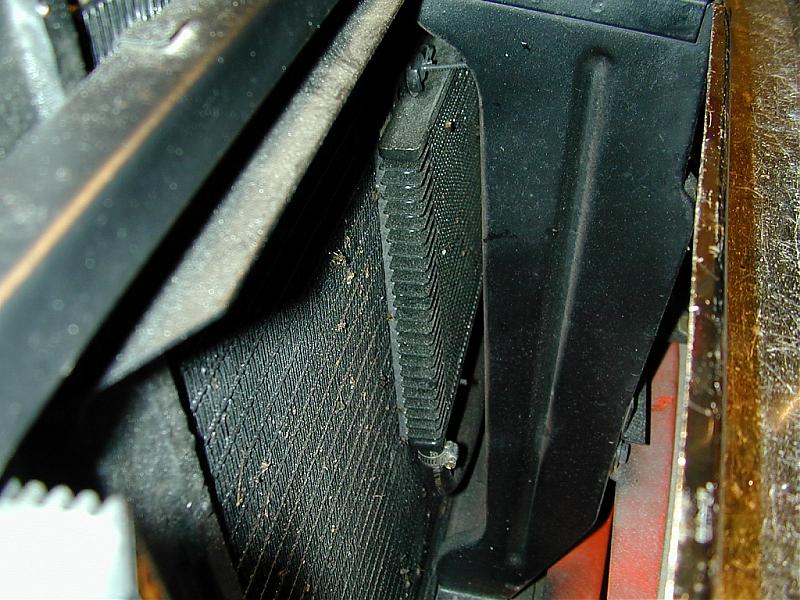

I assume your looking at one of these. I used a stack plate cooler and seal it to the radiator for positve flow at low speeds

When mounting a prf heat exchanger to the radiator air-on side, I always seal the unit by using 1/2" wide x 1/2" thick closed cell neoprene "camper tape" around the perimeter.
Mounting a prf tranny cooler and a ps cooler side-by-side on the radiator in this manner actually adds very little heat load to the radiator. But of course, the radiator and all other engine cooling system components must be up to snuff and functional. And the pieces must be mounted within the envelope created by the fan shroud...otherwise, you will have no air flow, even with ram air, due to "stagnation"/reversion.

I bought a bm tranny cooler for the ps cooler at tognotti's. There both mounted on rad on one side.

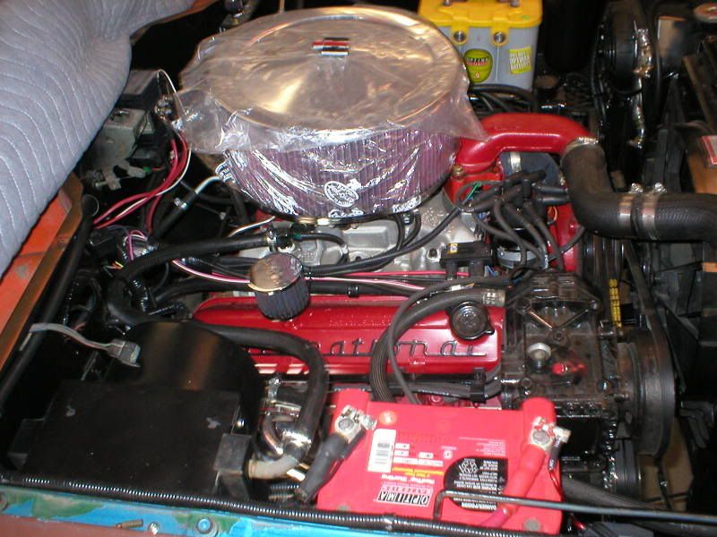

I found a pic from the rallye last October, what brand is that Chad. I'm looking at moving mine from in front of the radiator off to the side too. But my battery is right where your cooler is. Either I need to move the battery into the fender or to the other side, or put the cooler on the passenger side. But I think chads setup is looking like the "hot" ticket. Carl got a pic of where you mounted the cooler on your crawler?
Thanks, your Scout is looking very nice. I assume you will be putting a remote reservoir on that power steering setup.:smilewinkgrin:
