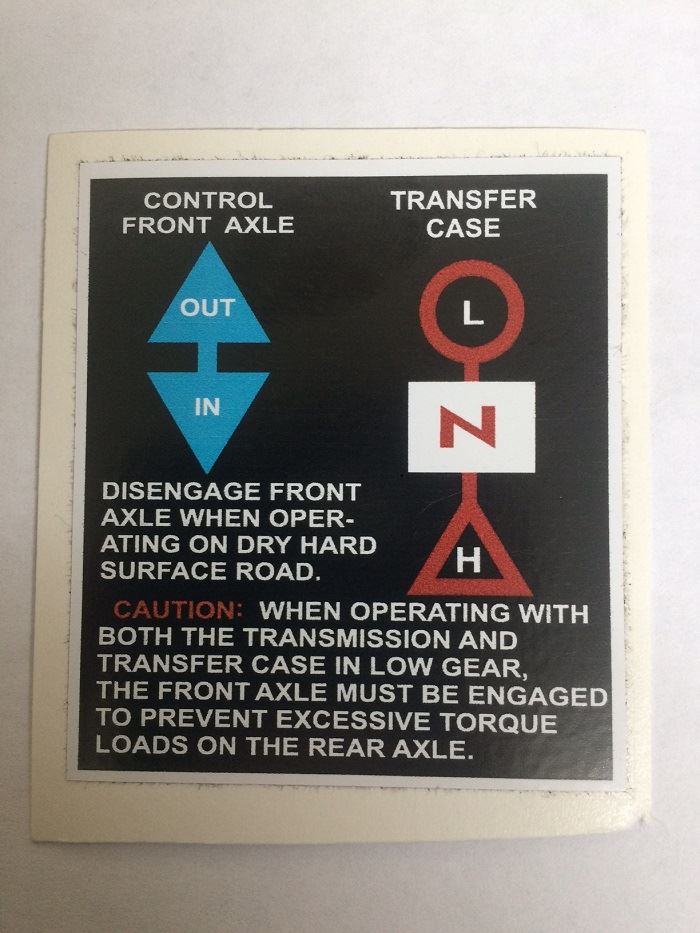

This is an update to my post which got no takers. I think that I may have figured out the answer to the problem that may not have existed. When I ordered the parts for my rebuild, I also purchased a decal that showed the shift pattern for my Scout 80. I believe that I received a pattern for a Dana 20 instead of Dana 18. Can someone confirm this please? As I can figure it, the output clutch shaft gear is either engaged or not engaged and there is no HI or LO. Ignorance is not bliss.
The Dana-18 transfer case shift decal is attached below.
The left lever (taller one) shifts the front axle In and Out of gear.
The right shift lever (short one) shifts the range from Low-Neutral-Hgh.
Dana-18 shift options are:
2WD HI,
4WD HI,
4WD LO,
Neutral.
