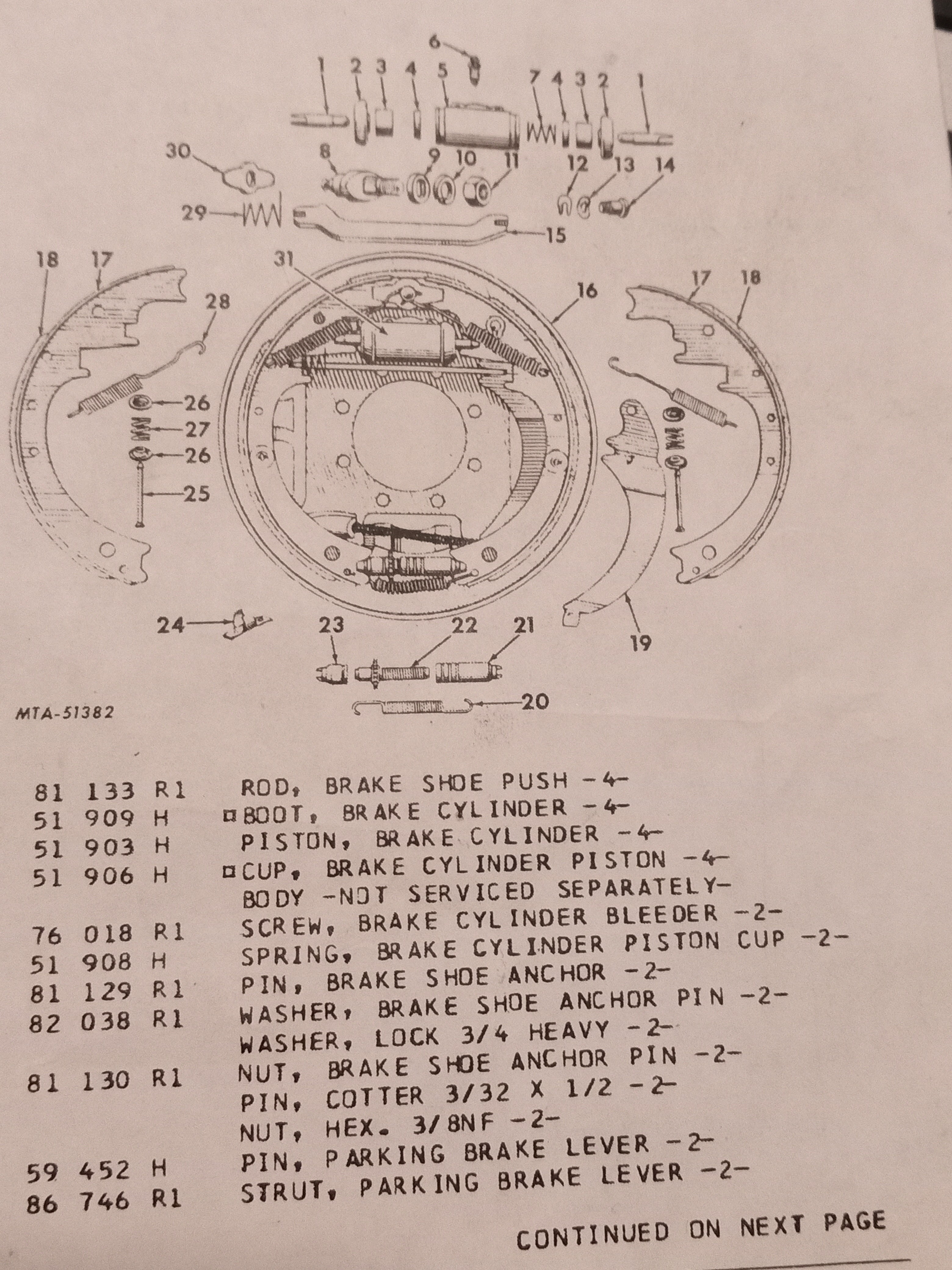

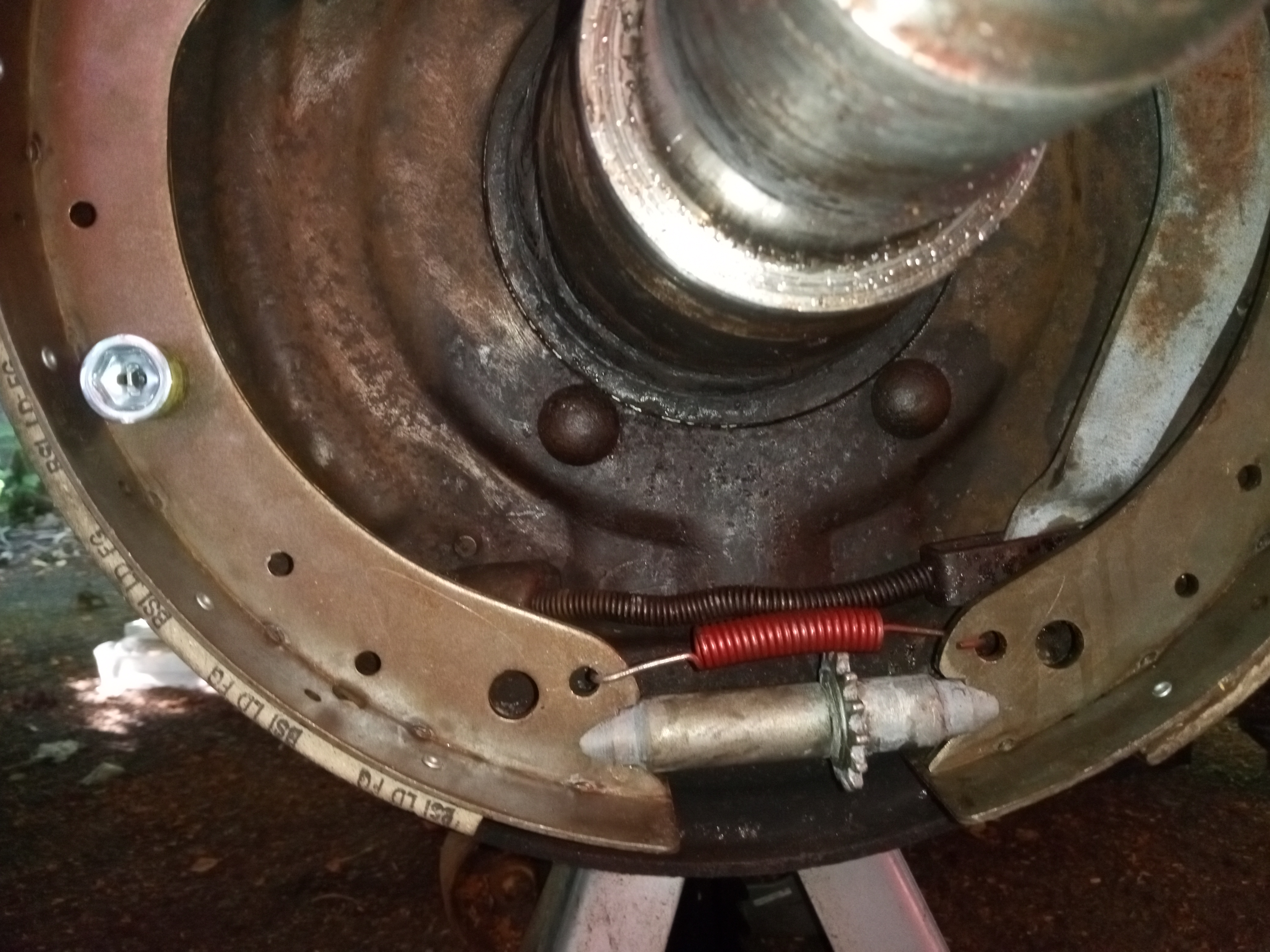

1300B, 1967, 4WD, 266 V8, Gas. I replaced all brake lines, hoses, wheel cylinders, brake shoe return springs, brake shoe hold-down pins, cups, springs, and wheel bearings. This was done in order to address a problem with brakes locking up. On short runs this does not occur (or is not noticeable) but I recently took a 30 mile trip and the rear brakes locked up. I let them cool down and was able to make it to my destination. Since the rear brake shoes were worn to < 1/8th inch, I decided to replace them. I noticed that the "spring, brake shoe adjusting screw" was stretched over the "screw, brake shoe adjusting" (star wheel). These springs, (one for the left, one for the right) were on the truck when I bought it, and mounted the same way. Although the part number in the catalog seems to refer to this spring, (the yellow spring in the picture) it does not appear to be the one illustrated in the IH parts manual. The parts manual shows a spring with long hooks clearly stretched under the star wheel. I tried to do this with the red spring but was unable to. Either red or yellow spring must be hooked over the star wheel and appears to interfere with its turning. It also appears that running the spring under the star wheel would interfere with its turning as well (or possibly lead to unintended turning of the star wheel). Could this be the cause of the brake lockup? How else would the spring be run? I carefully compared the new brake shoes with the old and they are exactly alike. The spring will not run under the star wheel on either shoe because of the placement of the holes in the shoe. The shop manual is of no help on this; it has a drawing of a brake assembly that in no way resembles mine and it is labeled "typical". I am looking to replace the star wheel brake adjusters, in case that may be a cause, and they may well be original, but no one seems to have that part.
To recap: 1. could spring routing interfere with brake adjusting screw operation?
2. How is this spring supposed to be run?
3. Any suggestions on where to buy spring brake adjusters?
4. Could defective spring brake adjuster cause brakes to lock up?
Thanks!
Usually brake lockup after driving a ways is due to to tight of an adjustment. The spring in question is to keep the shoes in the adjuster and keep the star wheel from moving to easily.

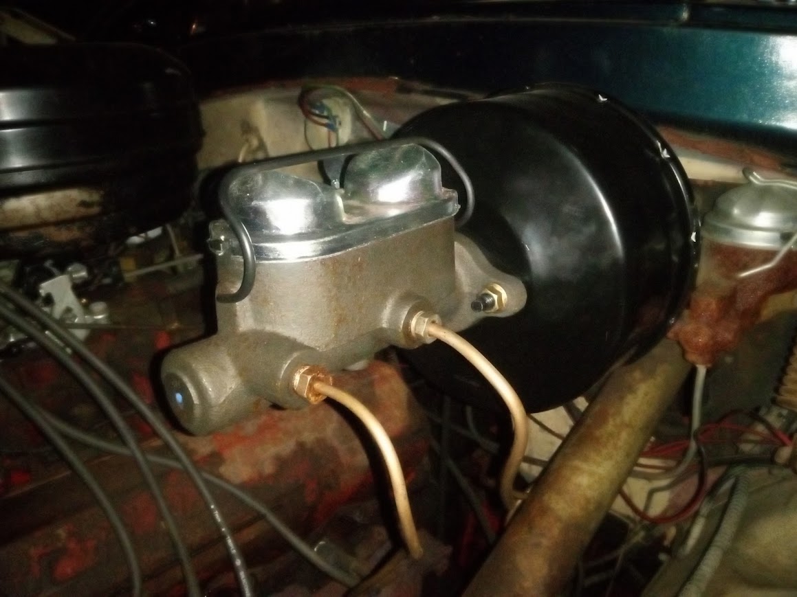

Update: the replacement master cylinder was the wrong one. The brake booster was also faulty. Both were replaced with new and I have driven about 250 miles so far with no lock up. Thank you to all who commented and suggested.

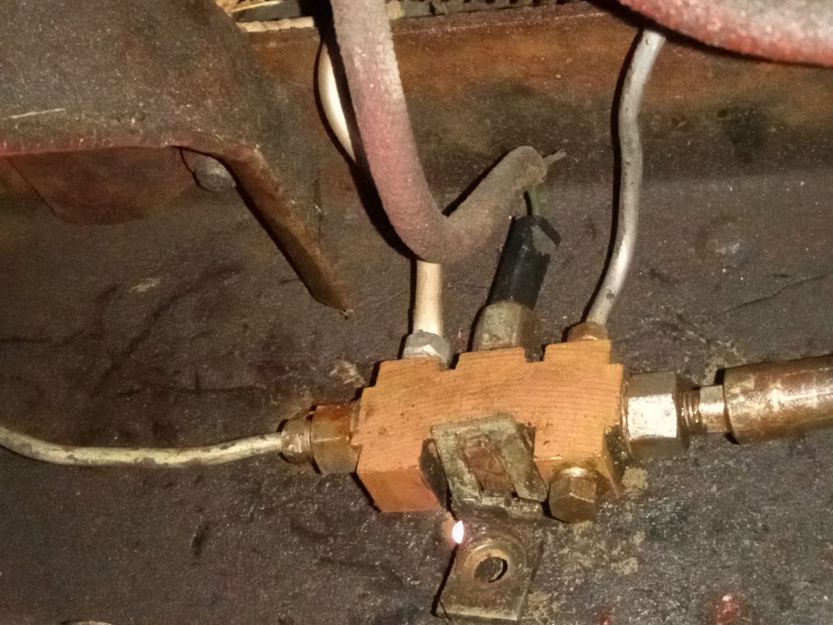

Unfortunately, a new master cylinder and brake booster didn't solve the problem, (see above) and the rear brakes have locked up again. I bled the rear brakes, but that didn't release them. I had to wait until the brakes cooled down, then they released. Having changed everything else, I'm thinking the proportioning valve might be bad. I had it rebuilt, but maybe it failed. Has anyone installed IH Parts America's MBM-PVC-B Universal Adjustable Brake Proportioning Valve & Distribution Block, and how did it work out? I like the idea of being able to regulate brake pressure on the rear wheels. (My initial posting from July 2, 2025 [above] has the details on what I've replaced.) If I do go with the IHPA version, below is the original warning valve, which appears to have only one wire going to it. The IH Parts America version has two wires on the sensor. Anyone ever deal with this?

Try opening a rear bleeder while the brakes are locked. If the release, it's a pressure build up. If not it's adjustment.
Thank you for your reply. They did not release after bleeding the left and right rear. This did work the last time the brakes locked up. Regarding the adjustment, would that be with the star wheel? I didn't try that. The brakes did release after about 25 minutes, just sitting there. Do you think the Universal Adjustable Brake Proportioning Valve & Distribution Block (see above) would help? As additional information, I put over 300 miles on this truck on separate trips over a period of 4 months, and now the problem has returned, without warning.

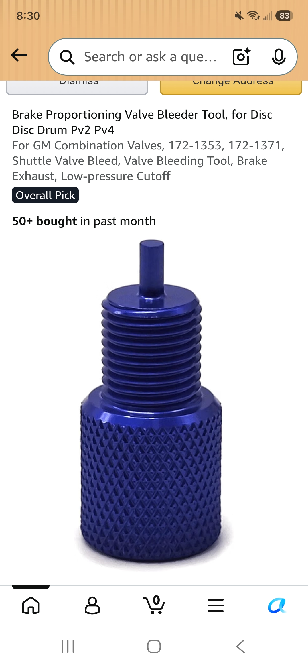

you've replaced the rubber hose from the frame to axle? What you have isn't a Proportioning valve its just a combo valve that diverts the pressure. The only thing that moves inside is the block off pin if you lost brakes on rear or front. If that has shifted it will lock up the brakes if there isn't a leak. There's a small tool to use in place of the sensor to keep it centered when you bleed the brakes.
I have replaced all the rubber hoses I can see. It sounds like the combo valve might be bad, given the rear brake lock up (both). I had it rebuilt but it is original to the truck as far as I know. I have an aftermarket version on order. What is the brake tool you refer to?
Might need to install a real will wood brake proportion valve on the rear output.
But if it's all stock it should all work.
IH Parts America has, but is not listed yet - SII-BRK-PROPOR-VLVE-DRUM
But before I get into the part I listed, a few key things need to be said here. A drum brake vehicle does not need brake bias adjustment via a "PROPORTIONING valve." A proportioning valve typically has a 60/40 split of fluid displacement relative to the pedal engagement. A disc/disc proportioning valve has a 50/50 split, just with a spool-valve to displace a defective or leaking circuit to mitigate total fluid loss upon failure.
What you are looking at is a "distribution" block. Which merely is just a junction with a brake failure sensor that will only indicate after your brakes have failed when you depress the pedal and the spool moves to one side. They are also a 50/50 split, which means no bias is happening.
Since your valve has been rebuilt, I can't quite speak for if it was done correctly. You should just eliminate the block and union your lines to see if the issue goes away. That would point your issue to a better direction. If you crack your line at the wheel cylinder, and the brakes depress, that means you have residual pressure 'somewhere' from the wheel cylinder to the master cylinder. Factory trucks have different sized hardlines to make for even braking when it was designed.

The bleeding tool is not needed for a distribution block.
