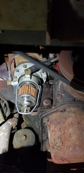

Well I went back on Ebay and made a deal on the pump I saw posted there. I received the box a few days ago and to my surprise it held 2 brand new Airtex 1117 pumps in the original boxes!! It took me a little work to get the fittings to match up as they are 1/8" pipe on the new pump and that's not what I had before.
I bought 6 feet of vacuum line as well and plumbed it up to my wipers... so for the first time I have working windshield wipers!!!
All I have is this photo from the underside. Truck is running great now.
