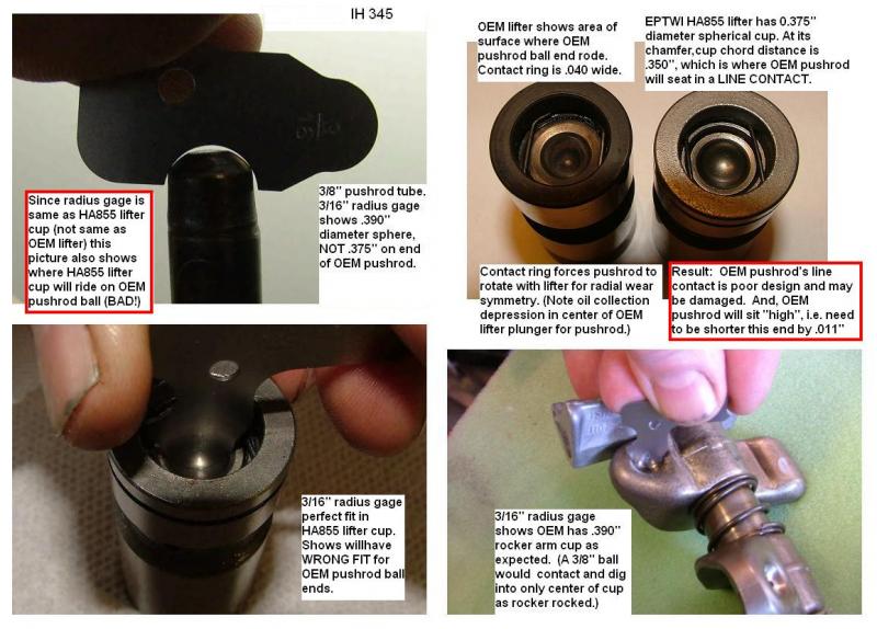

However, I have since noticed a discrepancy (trying to hide my frustration here) in the design dimensions of the lifters and pushrods.
Please see the attached photo for an explanation.
The oem lifter has a ball end based on a spherical diameter of ~.390” with a flat on it of ~.160” dia. For oil collection and to keep pr surface pressure on an outer ring on the lifter so it rotates with the lifter.
The oem lifter has an annular ring surface about .040” wide where the oem ball end rides. It also has a relief in the center for oil collection.
The rocker arm cup is ~.390” spherical with an oil passage in the center (the pr flat allows the oil passage to be free to pass oil).
The oem pr ball end rotates and nests perfectly in the oem lifter and oem rocker.
However-the new ha855 lifter has a.375” diameter spherical cup with a chord across its chamfered mouth of .350”. As you see in the photo of the radius gage (also .375” diameter) on the pushrod end, the oem pr .390” dia ball end will have only a line contact around the lifter cup at the contact location shown. Surely, a bad design waiting for damage instead of smooth area break-in.
This also produced a problem in accurate pr length assessment, since a .375” pr ball end will sink into the new lifter all the way, but the oem pr ball end will be .011”to.013” shorter (measuring virtual length to end of ball without flat, or same flat).
So….a “correct fit” would be a pr with an oem .390” dia. Spherical surface ball end with .160”dia. Flat on the oem rocker end (the flat for oil passage), and a .375” dia spherical surface with a .160” dia. Flat on the ha855 lifter end (the flat is still needed to ensure the pr rotates with the lifter and not just pirouettes in the center, not just for oil collection).
Another pic showing oem pr ball end contact area (sorry I forgot to clearly Mark it in previous photo on lifter). I confirmed contact area with dykem hispot.

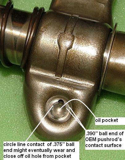

The following photo shows why I would be hesitant in going from .390" oem ball ends to .375" ball ends (even with the flats) on the rocker arm end.
Not the best situation to have. If you have any questions regarding the parts you purchased, consult the vendor you purchased from directly.
The IH rod ball is odd what you have there I have personally measured many and some wear over sized. All you can get currently as a semi stock pr will be 3/8 ball. See if 10mm ends are available. That is as close to .390 as you will find. The lifters are likely assembled from common parts including the rod seats so 3/8 is right as are the pr ends.
Suggest buying 3/8 ball/ball rods and running the common lifter size you find at your vendor. The rocker will be ok under stock like situations.
Not good for ya I'd disassemble the lifters and with a 3/8 carbide ball em spot the seats to your satisfaction.
