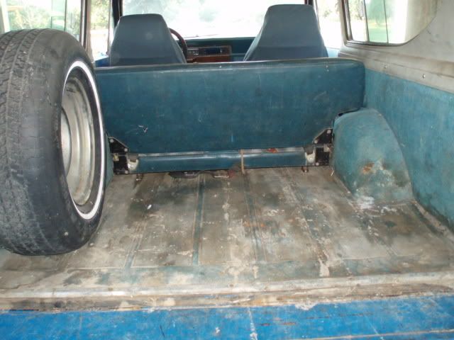

The owner claimed it was all original and that the top had never been off. Well, I don't know about that but it's complete and runs well...almost no rust too!

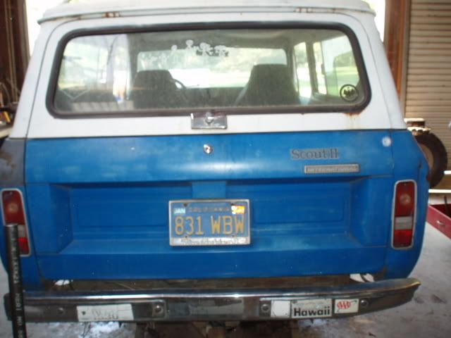

Here is the thing after I got it in the shop. I was excited so I didn't get any pics on the ground, but it looked like every other old stock binder.

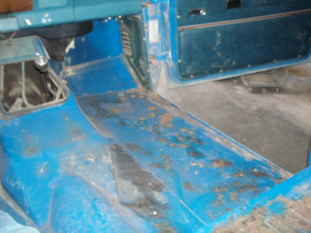

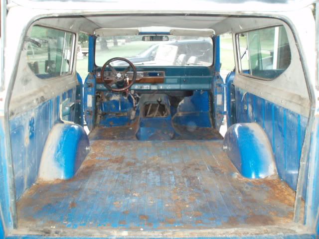

I just filled out my registration form for the rallye, so I guess I better get going. I removed the interior and was pleased to find less rust than I thought would be there.

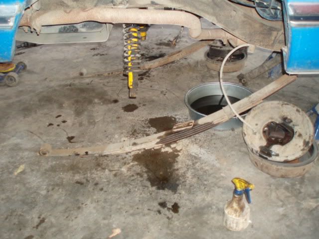

The top was taken off. Paint/rust removed from the floor, treated and sealed. I removed the rear axle and performed the spring over. After check fit, it was taken apart and cleaned up/painted along with the springs. I started on the front end.
The position of the driver's side brake line is very temporary.
