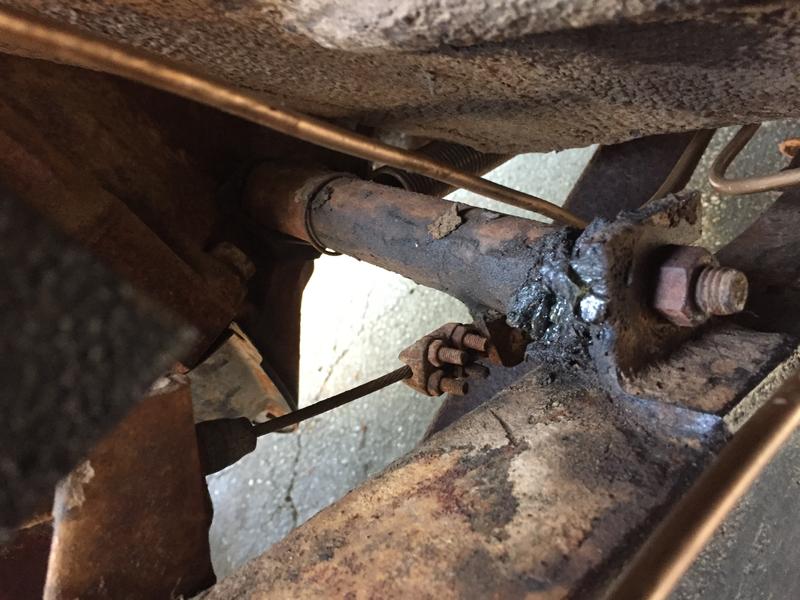

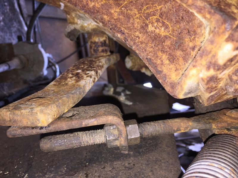

I see there is an adjustment on the clutch assembly which I assume is something I need to play with. Of most concern is what appears to be a hack job with these cable stops for lack of a better word on the end of the clutch cable. Maybe that is stock but I doubt it. Also, the clutch grabs really high almost to the point that there is no more pedal travel left. It is smooth though, no chattering or bucking during engagement.
Please see pics attached.
Looking for some direction on how to troubleshoot and fix both the clutch engagement issue and to see if these strap stops are stock or I need to buy a new clutch cable.

High towards me...so when the clutch pedal is coming towards me it grabs on the upper 80-85% completion of the path.
OK, I will adjust and see what happens.
Does that homemade cable holder look original? See my pic I posted...
I checked today and there is roughly an inch or so of play at the top of the pedal. It's roughly 95 degrees today and the clutch did the same thing...fast idle wanted to go forward, take choke off (600 rpm) no issue. I have not yet played with the adjustment but I will.
