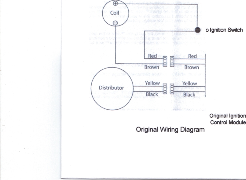

Here is a simple schematic for a gold box system that is copied from a pertronix conversion instruction set supplied by ihon member jmiller. Your gold box color codes May...or May not be the same as the callouts in this drawing.

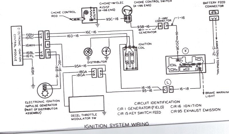

And here is the oem schematic for an sii with gold box, both I-4 engine and sv option.
Notice the discrepancies between the pertronix drawing and the oem drawing.
This schematic shows both a breaker point distributor and the gold box system...typical IH bullshit "tech" references...how confusing!
