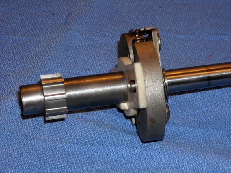

Need pics?
Here's a shot of the idn 4000 mechanical advance assembly with the shaft removed from the distributor for rebuilding.

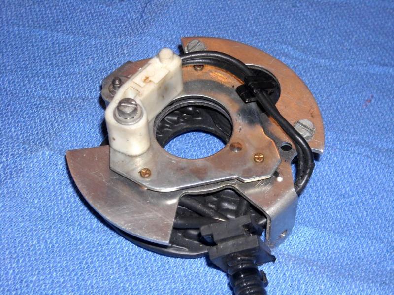

This shot is the "breaker plate" assembly for the idn 4000. The hall effect trigger is shown mounted on top, and the black potted amplifier is mounted under the plate.
If the amplifier fails, you simply replace this entire assembly.
Also, these distributors were used in both clockwise and counterclockwise rotation applications. So the mount positions for the vacuum advance link are marked accordingly. The ihc-produced I-4 and sv engines when used in motor vehicles are a clockwise distributor rotation when view from the rotor position.

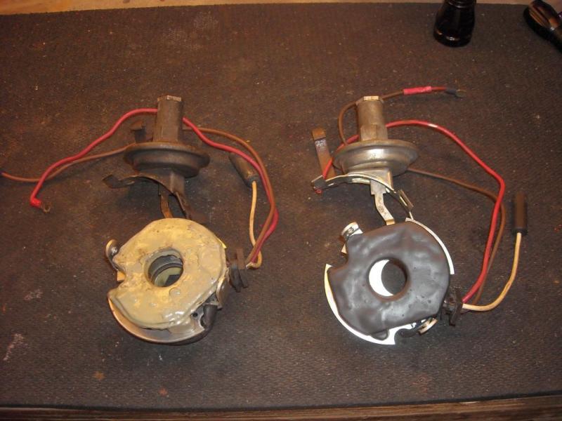

This pic shows a couple of failed idn 4000 modules(amplifiers). Both of these are "intermittent" failures, that means the system works perfectly for about 30 minutes, and then begins to occasionally misfire at random, then the misfire becomes very consistent (dropping random cylinders kinda like a rev limiter), then it looses all sparkability completely until the entire engine cools down and it comes back to life. That is the typical failure mode for the prestolite distributor and the same occurs for the Holley gold box amplifier.
The potting on the amplifier is a simple "dip" process which looks like a dog turd! But it encapsulated the entire circuit board. When these fail due to a heat situation, the potting becomes soft and pliable and a big air bubble develops internally. In some cases the potting material appears to have actually charred with an open flame.
I think these distributors are super-nice in design and engineering and never exhibit the kind of wear I see in Holley or delco units. And since the vacuum advance can on these can be partially disassembled, the "return" spring for the diaphragm internally can be diddled with regarding vacuum advance operation...and we can have these vacuum units remanufactured when needed.
However, when the electronics do take a shit, it's much more economical to simply convert the distributor to a pertronix and that does not use the failed "amplifier" at all. You simply leave the failed item inside and mount the p-tron!

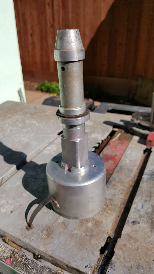

Here are some pics of the distributor and the various stages of disassembly. I'm waiting on the vacuum so I am taking my time getting it cleaned up and all back together. I will follow up with the assembly after it's all done.

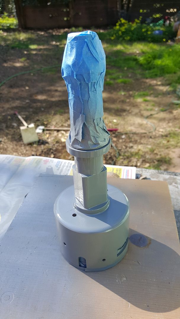

in the top pic here, in the center surrounding the shaft hole, is a plastic ring that is snapped into a groove. This plastic ring serves as a cover for four wicked oil reserves that feed a porous bronze bearing that the shaft rides within. In my case those wicks were as dry as dandelion fluff and blew right out when I went to clean out the inside of the distributor with compressed air. They can be replaced with a bit of cotton ball and saturated with motor oil (I used mobil 1 5-30). Be careful lifting up the plastic ring as it is apt to be brittle and also stuck. I broke mine but was able to get the pieces back in and secured the loose bit with some heat & ac aluminum tape. It's just a cover on the oil reserve so it should be ok. Very glad I dug down this deep, otherwise that bronze bearing May not have lasted much longer without any lubrication.
Didn't intend to get quite so deep into this thing, but as I addressed the thing that was plainly wrong (bad e-module) it became apparent that there'd never be a better time to address all the other things. I'd have never checked those wicks, and that bronze bearing would have likely been shot in a few more thousand miles... It really was on borrowed time. As it turned out, I think I rescued it in the nick of time. And discovered the vacuum advance was bad, which for some reason, I'd never previously thought to check.
Got it all back together. Here's the finished product.
