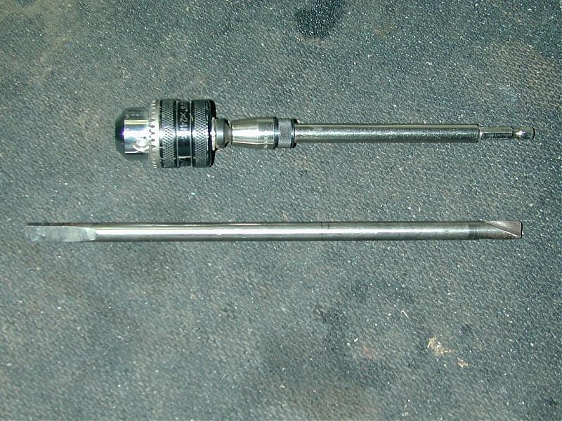

The overiding reason to do this is to prevent damaging the cam bearings when rotating an engine that has been sitting for an extended period of time. This is a peculiar anomaly that affects the ihc-produced I-4 and sv engines.
The "tool" I use for doing this I made from a 3/8" "aircraft drill" bit (12" long), ground to the same pattern as the drive tang used inna ihc-version distributor. The tool should be a fairly hard material, a long, hd screwdriver shank could be reworked also.
The tool should be ground to fit the oil pump drive slot nicely, not just something stuck in the hole! Otherwise, you can damage the oil pump drive connection.
Here's a shot of the tool I use, it should be turned with a hd drill motor capable of sustained operation at a minimum of 1500rpm.
