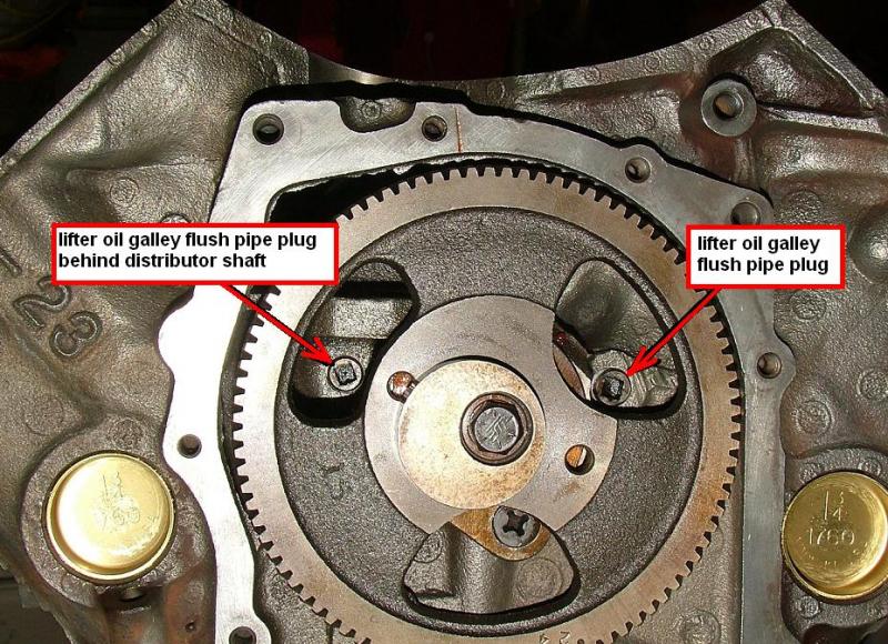

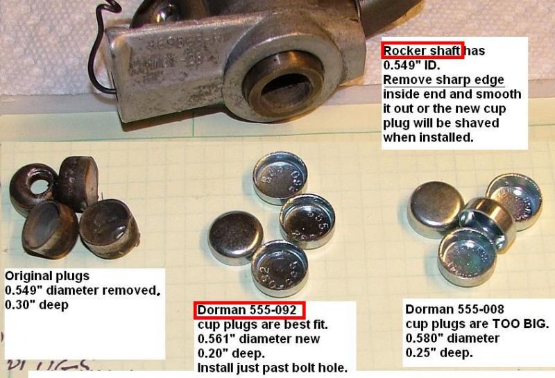

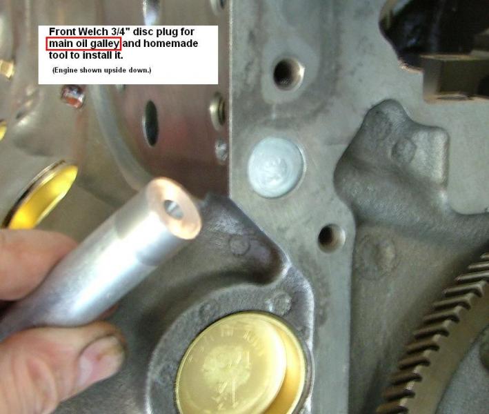

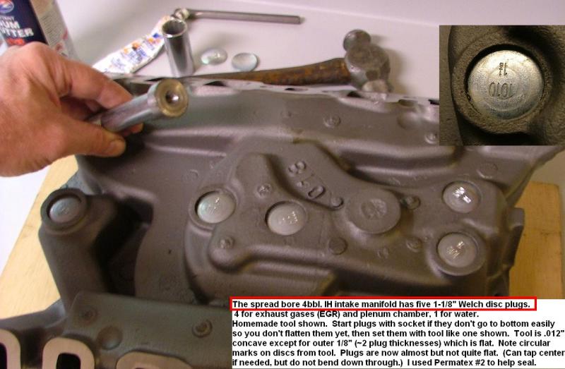

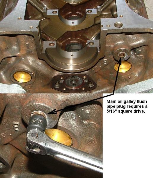

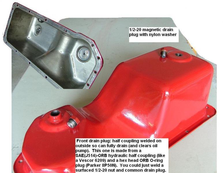

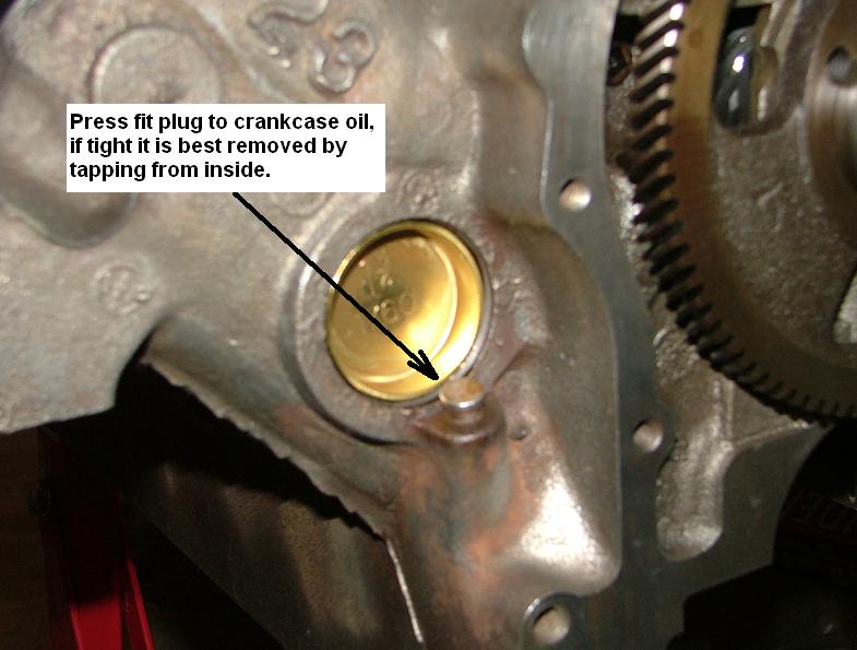

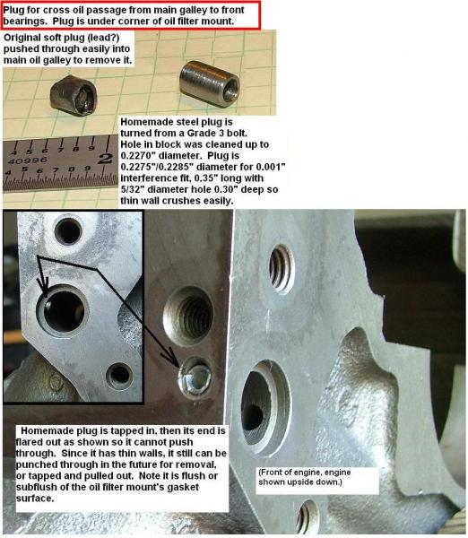

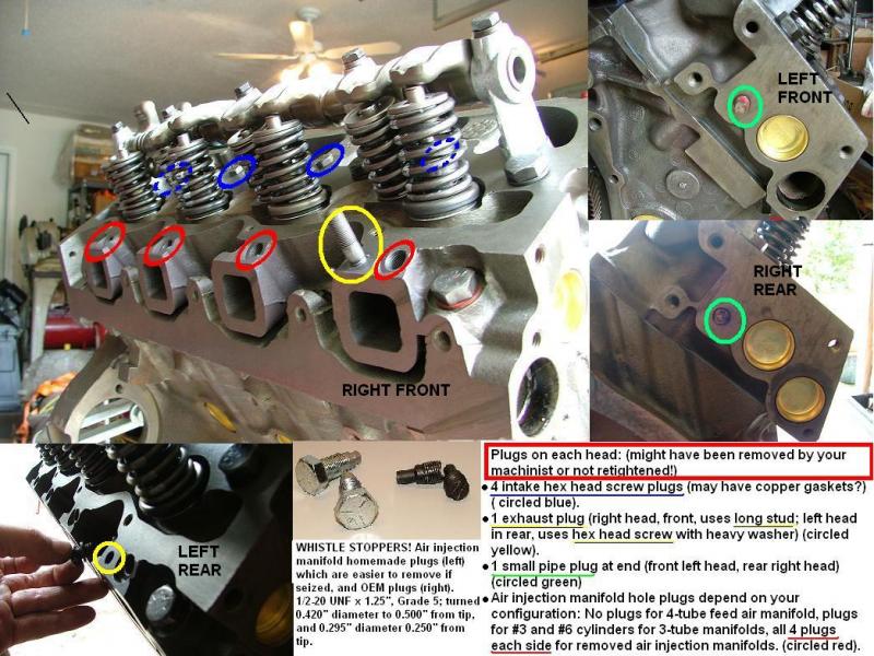

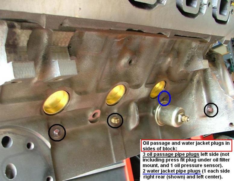

I thought I would share some photos and information of engine plugs, something to use as a plug checklist before you start up. Especially since your machine shop might have removed one and not retightened it. I left out the block's and heads' cup-type freeze plugs, since those are too obvious, right?
Photos are from one of my 1979 IH 345's. Comments?
